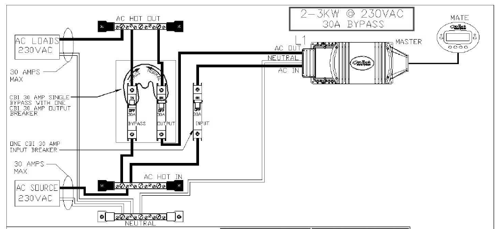

The invertor is a Outback Power VFX3024F single-phase Sine-Wave Invertor/Charger with 30 Amps AC Transfer switch.

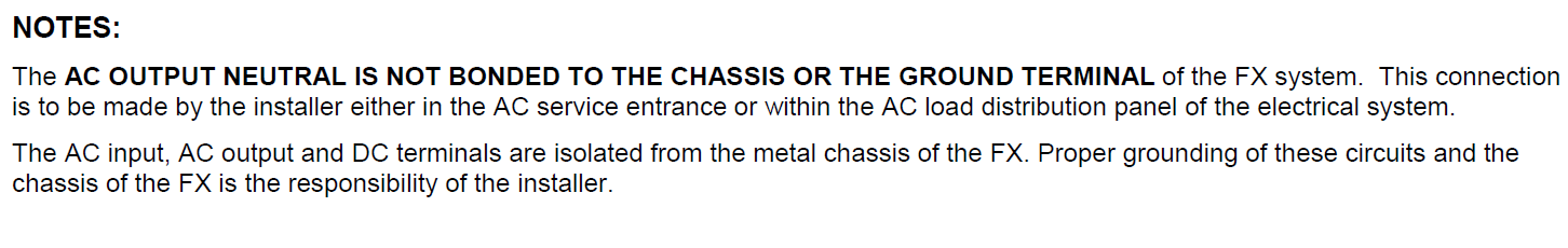

Also of note is:
[ElectriciansForums.net] TT System High Ze leading to possible Zs fails
So hopefully the installation earth isn't only connected to the ground terminal of the inverter.
It's clear from the manual that the inverter is clever and can be configured to not overload a generator and disconnect the output if too much is drawn.
( https://www.energymatters.com.au/images/outback/FX-VFX-Manual.pdf )
With final circuits RCD protected, I'm struggling to see real-life issues with this setup.
In this case the inverter isn't IT, N is passed straight through it.
So whatever earthing the generator is will also apply to the inverter output.
Also of note is:

Hi Tim,
I managed to get hold go the guy that set up the generator and invertor and he confirmed that the AC output Neutral has been connected the ground terminal. He also advised that the only protection the invertor provided was anti-surge san that was to protect the invertor itself and would not disconnect the load side feeding the house.
The invertor has a max output of 3Kw and when the generator ( 9Kw) kicks in it feeds the house while the invertor charges the battery. Im lead t believe then that the only protection the generator and invertor provide is a C40 and B32 respectively.
Everything is on 30mA RCDs thereafter with only the B32 mcbs failing in regards to Zs ratings (which can be downgraded if need be).
