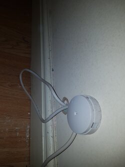

Doing an EICR today and customer has a tumble dryer in the shower room.
Room is an L shape with shower directly in front of door and around corner under stairs is a tumble dryer.
it is fed from a socket in the lounge next door, cable has plug on it in socket that goes along skirting through wall to a junction box on wall where tumble dryer connects. its outside the zone as the wall is out of the zones and has a wall between the shower and junction box.
not sure of reg in 18th but it was 701.55 in the 17th regarding appliances in bathrooms/special locations.
would you C2 or C3 it? based on this description and picture below?
suitability of accessories/means of isolation are just some of the issues that come to mind.
I have for now coded it c3 as its not powered from the shower room but needs improving and there is no loose connections or thermal damage. the junction box is now rotated to be sealed better. In anycase customer is having me fit a switched fcu and run a proper feed to it.

Regulation 701.512.3 permits 230 V socket outlets to be installed in a room containing a bath or shower, providing they are installed 3m horizontally from the boundary of zone 1.
Regulation 701.55 restricts the type of fixed and permanently connected current-using equipment that can be installed in zone 1. Washing machines and tumble dryers may be installed in a bathroom provided they are:
  • supplied from a switched fused flex outlet installed outside the zones (socket outlets are only allowed 3 m horizontally from the boundary of zone 1);
  • protected by a 30 mA RCD; and
  • permitted for such installation by the manufacturer.
I had this a few years ago and it was in zone 2 and fed by a switched spur outside of zones and rcd protected
I was initially unhappy with this set up but after speaking to my scheme provider technical dept and reading the regs again
They assured me if the manufacturers confirmed in writing or instructions the appliance was IPX4 then it was fine
It was IPX4 and they all are apparently
