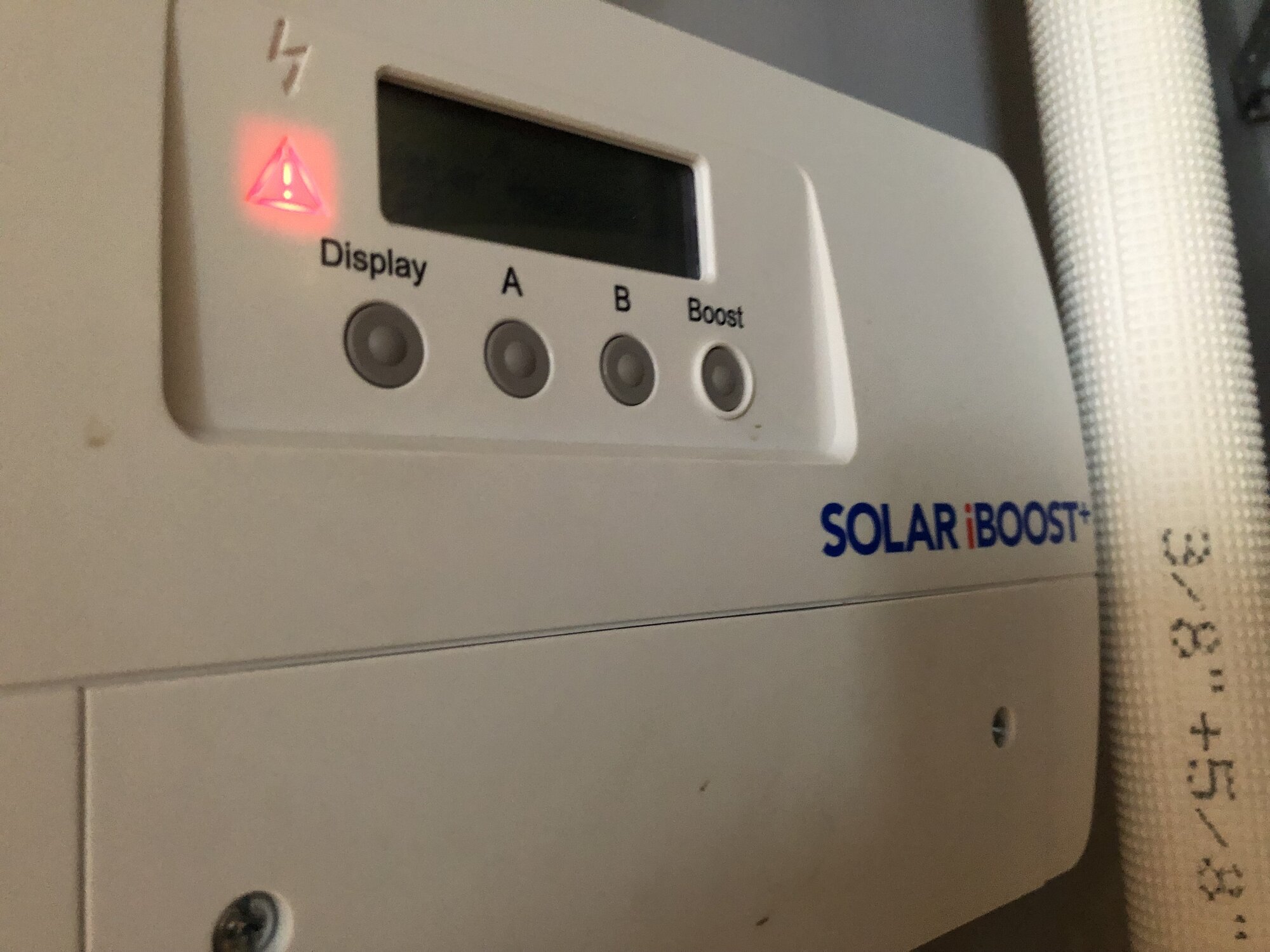

Husband had solar panels installed plus a booster "Solar I Boost" 2 years ago. Ongoing problems with the booster. I have spent the last year manually boosting the water heating twice a day as we never have enough hot water. I just want to turn if off and have constant hot water. Please can someone tell me how I do this? I cannot see a switch any where and I don't want to make things worse. Happy to get in an electrician to disconnect if I need to.

How was you hot water controlled before, manually via a switch? You cannot switch off the iboost as your electrician will have rerouted wiring to the unit and it should also be connected to your thermostat/s. Has the unit never worked properly or is the issue of not having hot water new.
How many kw is the unit saying you saved daily?
Any messages on the iboost unit? Lost signal etc?
After a period of solar and the iboost being on does the unit display Water tank HOT?

Not sure how much power is saved we put some back to the grid but because I boost the hot water a lot savings are reduced! Had problems with it for over a year.
Yes it says lost signal. Pretty sure the solar is not kicking in at all as we have very sunny days and if I have not manually boosted it we have cool water.
It will display Water Tank Hot if I have boosted

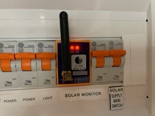

Re the lost signal I did try and looked on line several times as to how to re- pair the sender but we were not given a pairing part/sender. So the instructions don't make sense. I did not want to fiddle with what I thought was the pairing part on our switchboard ( photo attached of switchboard and what I believe sends/receives the signal).

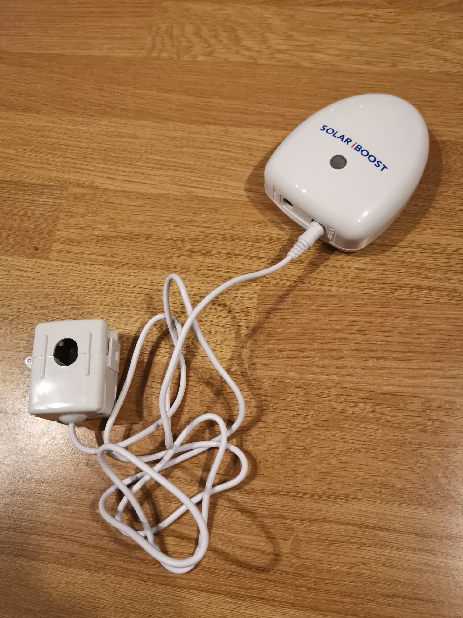

Sorry I see you have a different sender. Do you have a link to instructions?
It sounds like kt he sense is faulty and needs replaced. I wouldnt get rid of the iboost it's a great way to use excess solar when you don't have batteries

No we don't have one of those senders. Thank you I feel better able to have a discussion with an electrician following your help!

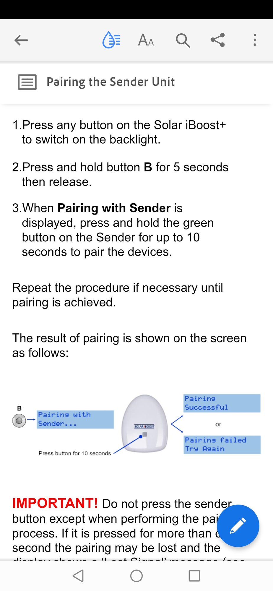

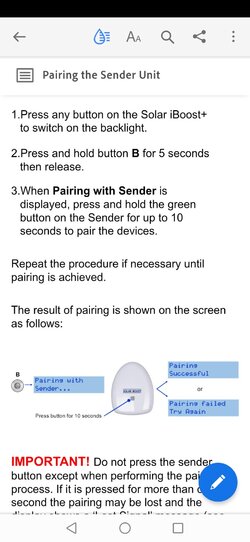

As a last attempt before calling an electrician you could try pairing using this. There Must be a pairing button on the CT transmitter or a way to initiate the process in the man
ual. Good luck 👍
