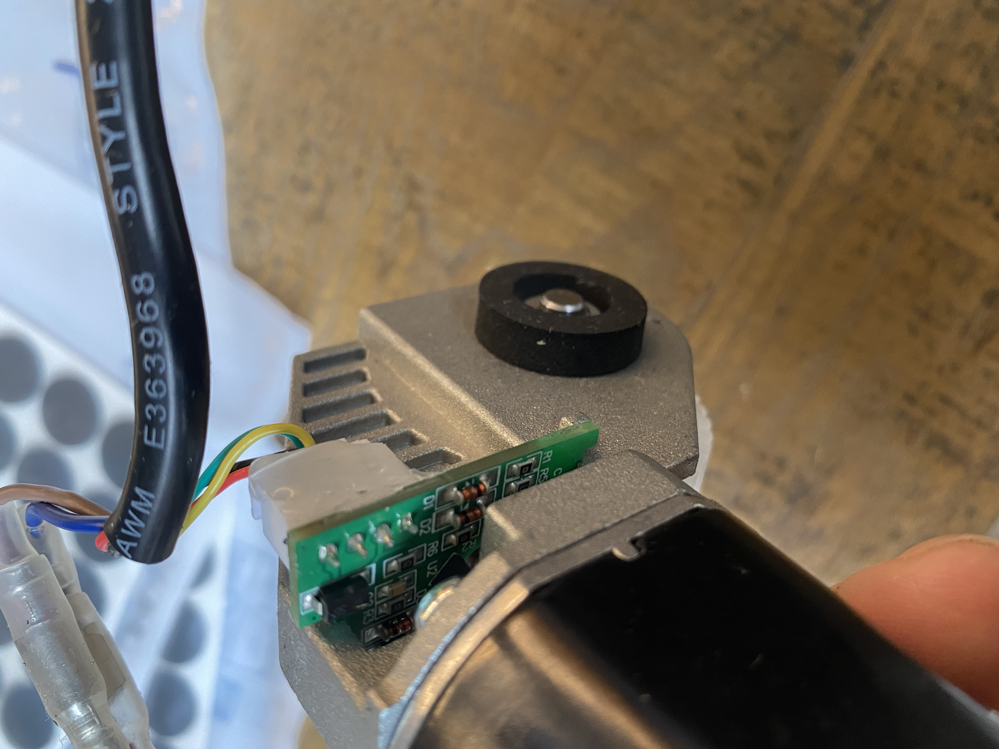

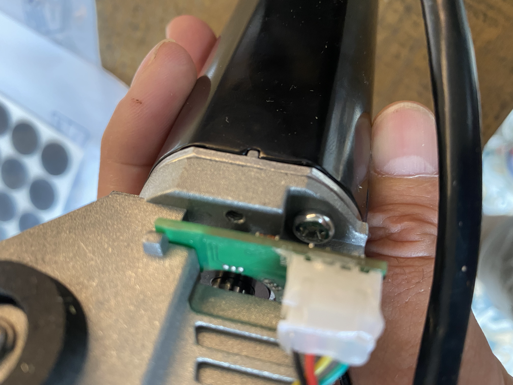

Hi.
I want to control a TV Lift from a home automation system. Its hasn't got any standard way of doing this and the person setting the home automation needs to know just a few things to get it working.
Ive had an electrician look at the control box and motor, he's figured out that the control box sends power to the motor for up and reverses the polarity for down, brown/blue. There are then 4 more wires coming from the motor to the control box and he thought that they must be the limit switches that shorts to stops the motor going up or down, but he couldn't find a correct short, they were all over the place.
Ive attached a photo of the motor and wires attached... any help would be very gratefully received ... here's hoping.

I would say they are not limit switches, but what you have is in fact a rotary encoder... similar to those found in the original computer mice (the one's with a rubber covered ball that rotated against rollers).
With two opto-transistors, detecting the rising/falling edges of them allows you to determine which direction the rotation is going in (in one direction, say signal 1 will lead signal 2, in the other signal 2 leads) and how much it's rotating (counting the pules).
Four wires is enough... and this is just an example... 0v and +5v for IR LEDs and two signals back from the transistors.
What you need is an oscilloscope to watch the signals as the drive is running. This would allow you to count pulses per revolution and determine which leads for each direction of rotation.

Just to be clear... I'm assuming this is what that board is... I could be wrong... but if it is a simple rotary encoder, you'll be getting two signals out of it. To complicate it, the lines could be sourcing a signal (in this case, they may be switching between say 0v and 5v) or they could be sinking a signal. Sinking is a little trickier to look for, especially if the other end is not connected to the controller because when you sink a signal you may pull the line high to say 5v using a relatively high value resistor.... when the transistor is exposed to light, it basically connects the line to 0v or vice versa.
My advice would be to get the model/part no. off the drive or the PCB and go looking for a data sheet for it.
All that aside, if it works as I've outlined above, you may get something like this....

I agree with @SparkyChick that it is probably an incremental encoder, as it appears to be on the input shaft of the gearbox so it would do multiple rotations for an output turn (so simple limits not likely to be there).
Most professional incremental encoders have an index/origin pulse to get the start point, but if geared down you really need some means of knowing a specific location on the output shaft to get your known location.
It might even be simpler to look at some absolute encoder systems, from a simple potentiometer to one of the encoders that had the equivalent of a grey code or whatever internally so even from a reboot/cold start you know where it is.
In all cases you should have limit switches as you should never have a single point of failure in anything that can break itself or something/someone important! In fact, if it has any real risk of that you ought to be doing a detailed risk-assessment before going through the design requierments.

I went back with the other suggestion to my installer and he thinks using the mechanical limits as a failsafe is the way to go and just to solder wires to the up and down buttons and he can simulate the button push ….
