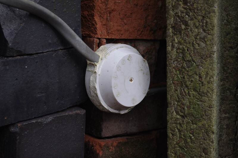

Guys has other people encountered twin and earth used on plug tops before seen it many times now and becoming more common
It is totally wrong, as we all know..but it has been going for years! Doing well though getting 2.5 in.
And of course, what the plug top is feeding is not part of the installation, as it is plugged in.
I have done it a couple of times as temporary measures when disconnecting peoples boilers or whatever when doing a rewire, I certainly wouldn't leave it like it though as its not ideal, it works but is a pain getting the conductors in!
Seen it a few times over the years, one of my neighbours is a classic example of incorrect T&E use, his garage is fed by 6mm² T&E clipped to garden fence and extended with a 40A JB sealed with bathroom sealer!.
Must get a pic sometime :D
