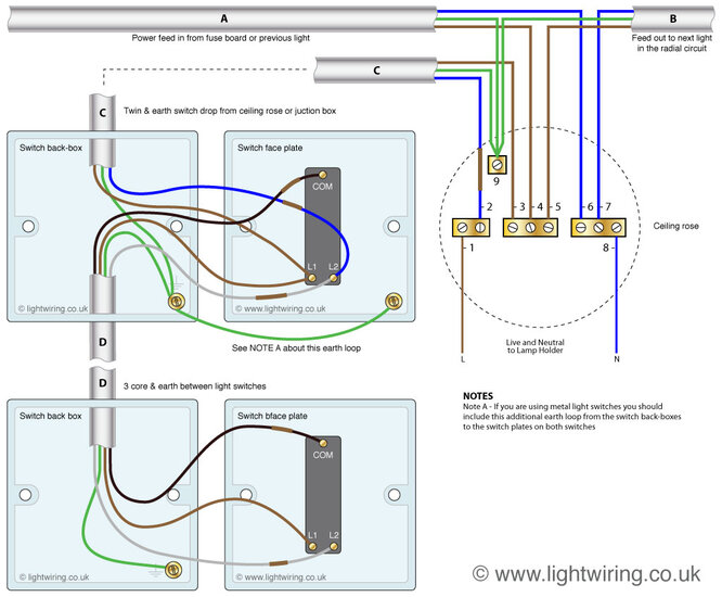

Hi Chaps,
Re: The picture....
Is the Brown Wire that goes in to L1 on the second faceplate a permanent live?
If so, could I change the faceplate to a 2 gang and add a link from the L1 to the Comm to feed another lamp?
Thanks,
T
