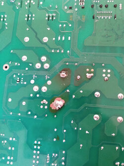

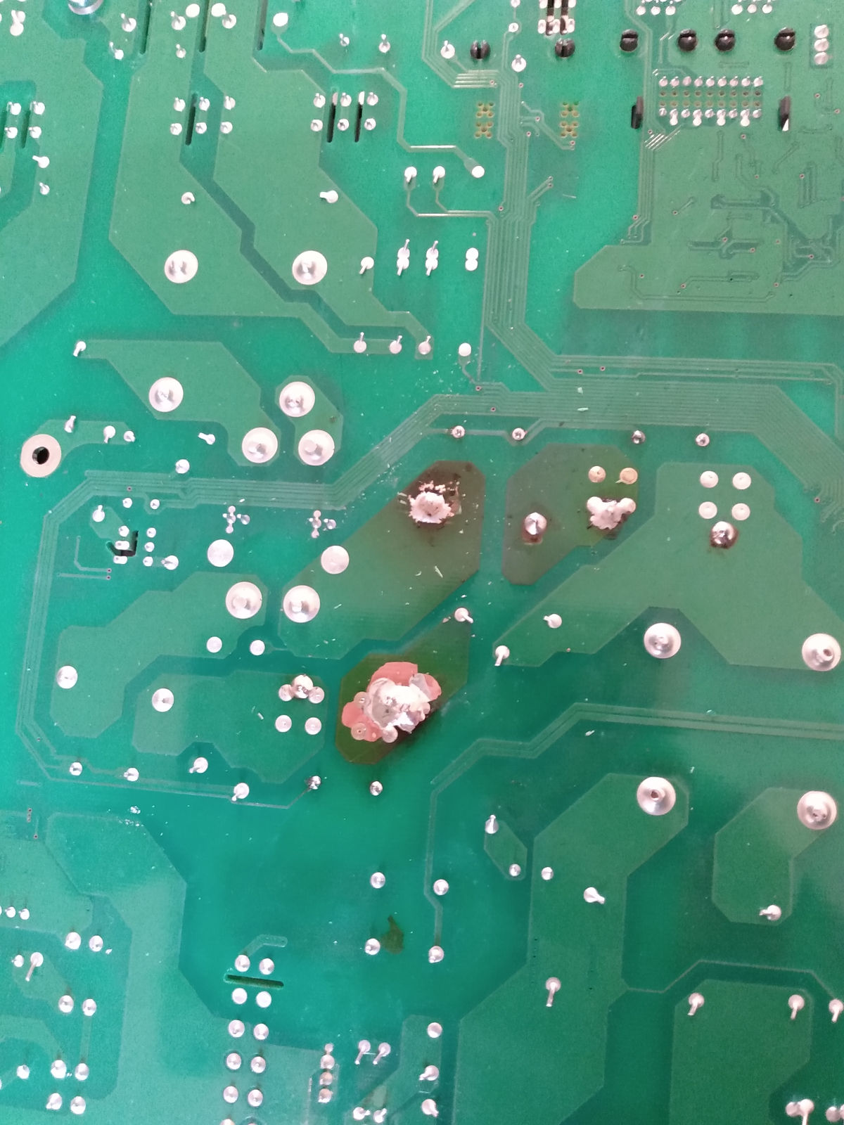

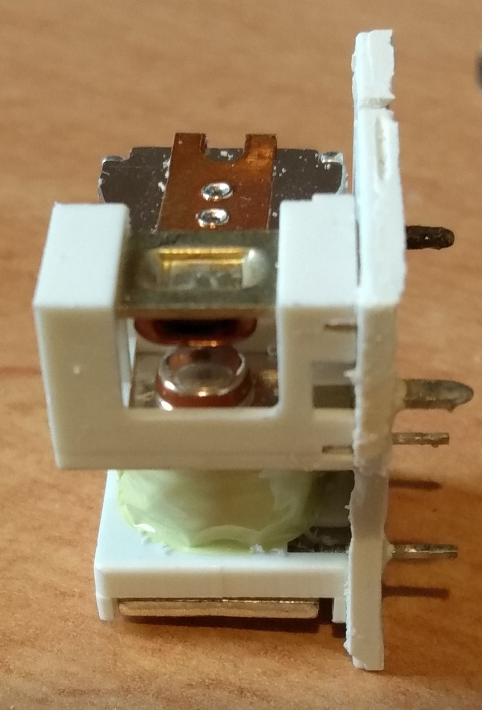

Here are some photos of the burned out Zettler relay:
[ElectriciansForums.net] Type AC RCD with solar inverter
The contacts look perfect!
What is burned out is the pin from the steel magnetic frame that the moving contact uses as the path to the PCB. Yup, that is a 30A relay using a 1mm^2 steel pin, so equivalent to 0.125mm^2 or so of copper!!!

As mentioned earlier, the original installers had not earthed the 3C 4mm SWA armour 'deliberately'. It was sort of connected at the load end via the 3rd core CPC to the inverter, to the metal outdoor box, and metal box happened to be making contact with the gland (but no banjo, etc). So I also used some Earthing nuts at both ends and added CPCs so the inverter now has "high integrity" earthing as well with two separately screwed CPC leads to the CU earth bar.
Also to add, the inverter's PCB hole where the burnt out replay pin came from was trashed - the through plating long gone. So for the new relay I wrapped a strand of copper wire (just one of the strand off 1.5mm conduit wire) round the pin and soldered it, then drilled the PCB to about 3mm hole for the "whipped" pin to go through, and then lots of solder on top to try and carry the heat away.
