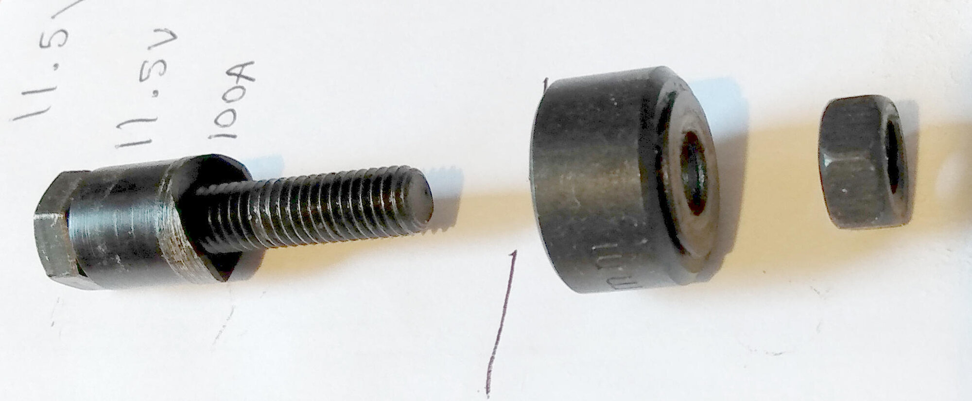

How exactly do you use them? The only ones i've been able to find on youtube use something that looks like a drill so comparable in size
The cup part goes on one side of the sheet, the die part other side, and then you tighten the through-bolt until the die is pulled through.
Tighten it with what? I need to see one of these in action i can't picture how they're used. I've seen the milwaukee ones that use a gun type thing but not the manual ones
Are you thinking of a cone/step drill, or a hole punch?
The cone/step drills are used just like a drill but as you push further in it gets larger.
Here is a hole punch in parts, dashed line where the metal sheet would be:

I see your punch has a nice big nut for tightening, which means you can use a ratchet and socket. My old ones were like that but recent ones are tightened by hex-wrench, which is not as good, imho.
You could change the bolts for hex-head ones, though often Alla bolts are in higher tensile steel (10.9 or 12.9, not the common 8.8)

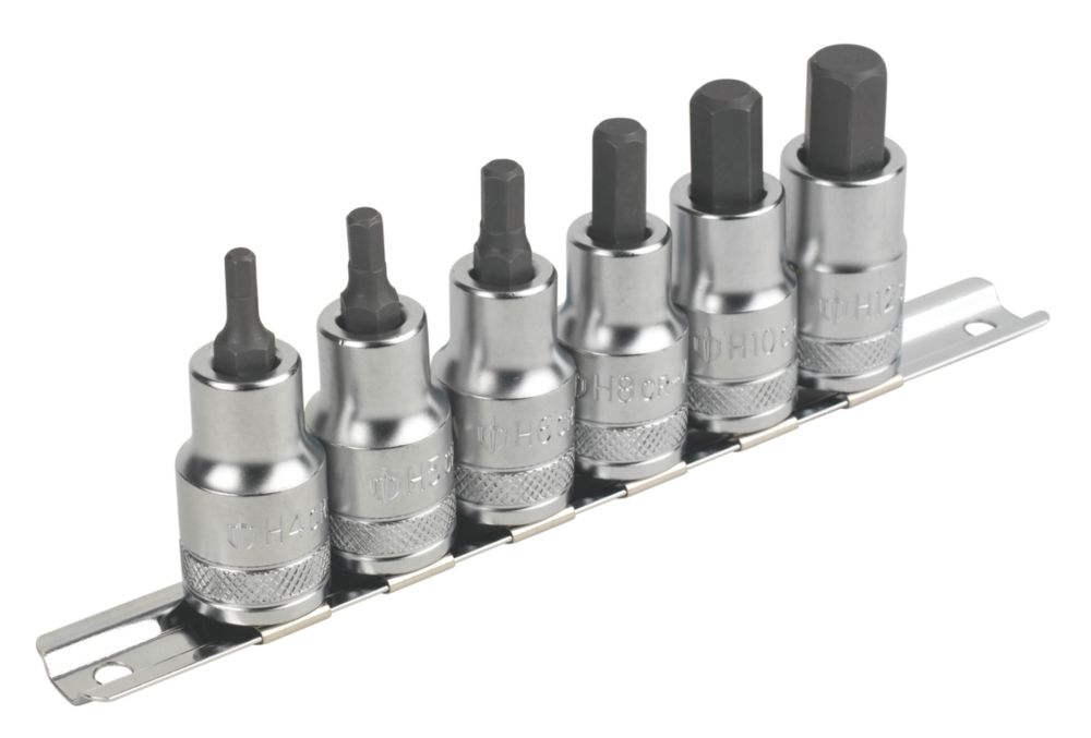

Or get a set like this:
Thanks @pc1966, that looks like a good set of hex sockets. I do have hex bits, but then you have to put them in an adaptor for a socket, which makes it a bit unwieldy, a bit wobbly, and of course increases the height when you want to go low profile. However, I'll probably get that set anyway.
I must have dozens of "sets" of assorted bits, sockets, security bits...I really must stop buying stuff!
