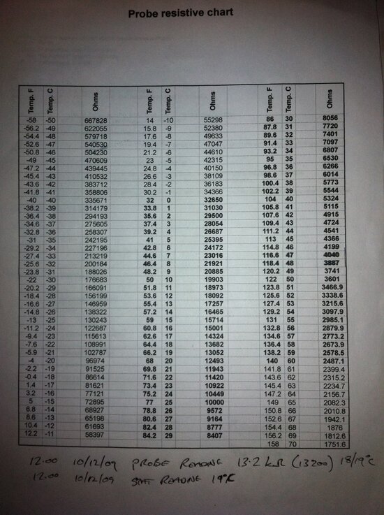

I have a problem with some underfloor heating can anyone help? Was called to a job as the underfloor heating had stopped. It appears the controller is showing the temp as 33.2 degrees and will not move down to bring the heating on. The controller upper limit is 35 degree when you set it to this it comes on but, soon switches off as it thinks it has reached the correct temp. The controller has a indicator to say if the probe is faulty and it's not lit. It's under guarantee but the company will not send anything out until I can confirm what's at fault. Don't have much experience of these but think it's either the probe or controller. I can test the probe however don't have any paper work so don't know what the Resistance should be.
Has anyone any suggestions?
Cheers

Hopefully attached is a photo of typical readings of a probe, I think the info was from heatmat, but not too sure now.
Hope this helps

Many thanks for all your comments. just one point the indicator on the controller did not light so it thinks the probe is ok. I think SYkraps got it the wrong way round which makes me think it's the controller?
That's great just one thing I dont know what the temp is as its not working. Controller showing 32 degree but as it's been off day's that cannot be right. Do I use the general room temp?
