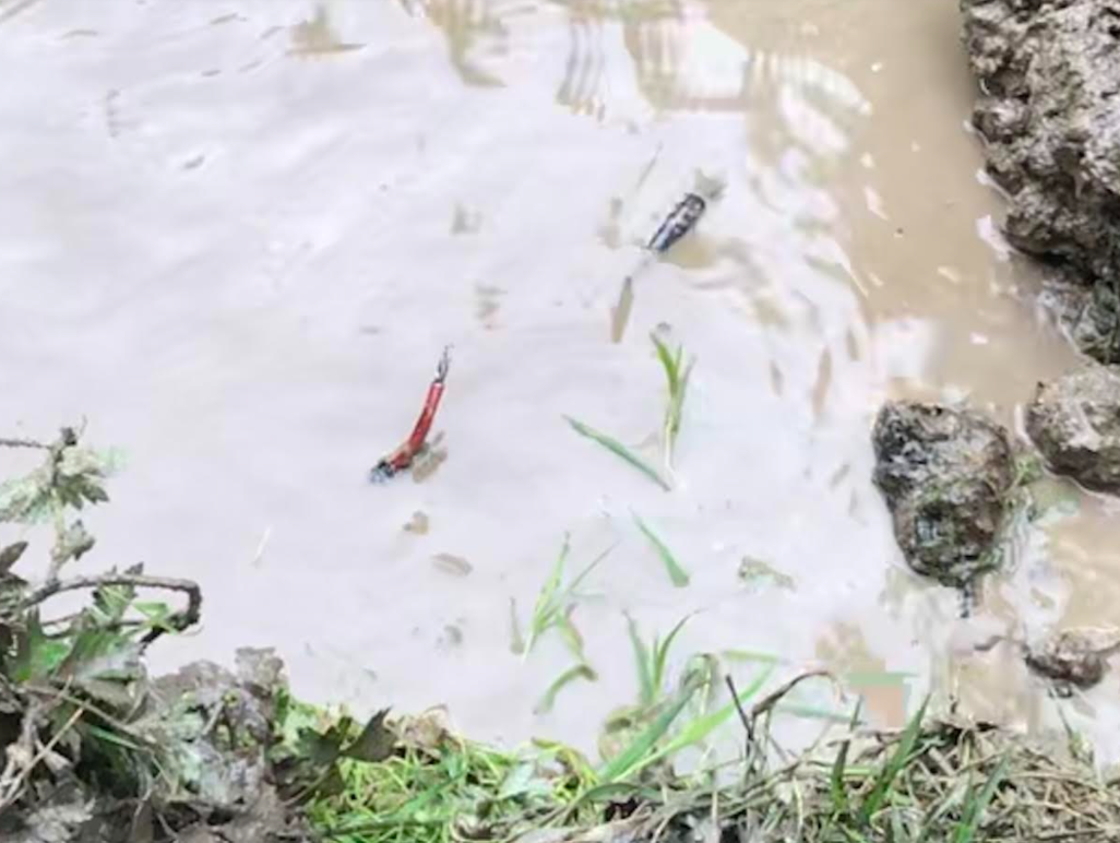

In this case when I first arrived the cable was rising from the lake saying "SAVE ME!!"

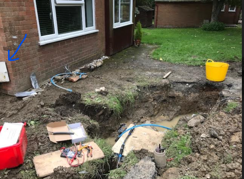

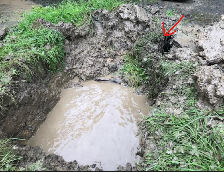

The poor guy (who I know well) had a terrible day. He started off with a mild leak on a stop cock. (red arrow)
There was a digger on site and he borrowed it. I still don't get why he dug where he did. I was on site anyway for something else.
I get a call from him "you'd better come down to number 2". At same time I started getting calls saying various things had no power.
By time I got there he'd dug a bit more and there was an impressive growing lake. He'd severed the power, and there was an unprotected 22mm copper water pipe he'd also spectacularly mangled up.

The scene a while later....the trench running towards the house is where he severed a copper water pipe - looking at where the gas cabinet is (blue arrow) I was initially worried he'd managed the triple crown and got all three services!

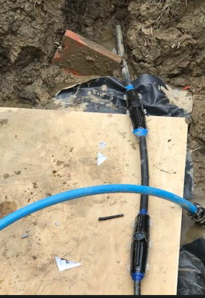

A year earlier, I'd found the two houses pictured shared a neutral on an EICR. 10 months earlier I'd dug a hole 10m upstream and connected a new cable to the one he severed, and ran a new supply to the far house. I wasn't delighted to be back there getting muddy so soon.
