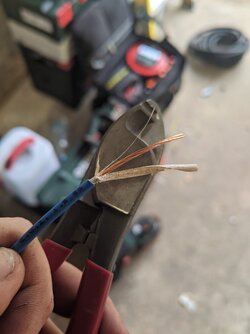

I was working with some odd singles today from Batt Cables, they seemed to have a plastic like braid between the insulation and the copper, almost as if it's some kind of fire rated cable, I don't believe it was LS either, it was a bit of a pita to get rid of the braid and my prysmian rolls weren't like this. Is this anything anyone else has seen before? I can't even find anything detailing it on their site.
I can post pics tomorrow since I have a few scraps but I don't feel like walking outside in the pouring rain to grab them.
Here's a picture, forgot to post on Monday.

Fire resistant,
Fire resistant,
No wonder, I thought it was something like that, but I've never seen it in singles, only FP.
