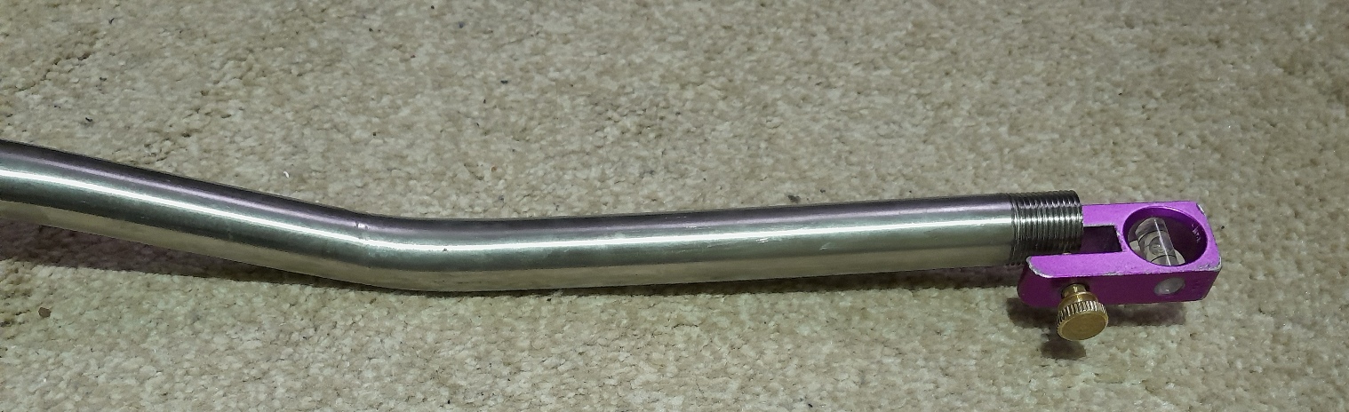

It's simply a level that clamps to the end of a bit of conduit during bending sets. Make first bend, attach level (with bubble level!) to conduit before removing it from bender, twist conduit 180 degrees to do the other bend until bubble is level, then make second bend. The level guarantees the second bend (and third and fourth bends in a bubble set) will be exactly inline with the first. This will work even if the conduit bender is not on level ground. No more messing about looking down the conduit to line things up. I use it extensively during conduit bending work, and wouldn't want to be without it. Had to buy it from USA.

this tool would haved saved me from a load of scrapped tube back in the 70's. I could never form a saddle or set that wasn't pi$$ed. eventuallyused a pencil line to determine the position in the bender.

I taught myself to do conduit jumps after failing a practical on on it
Wasn't that hard and came in handy on installations
