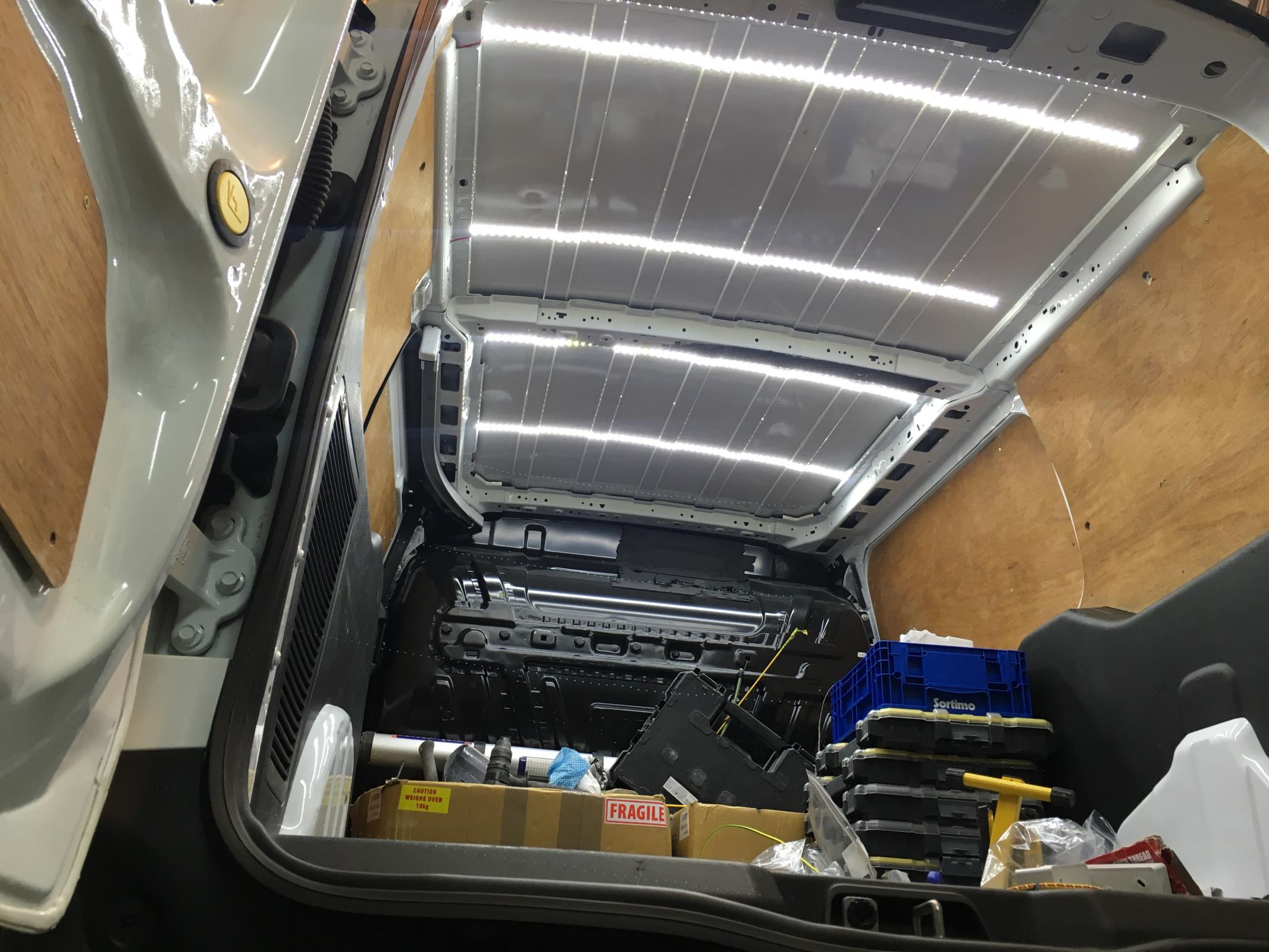

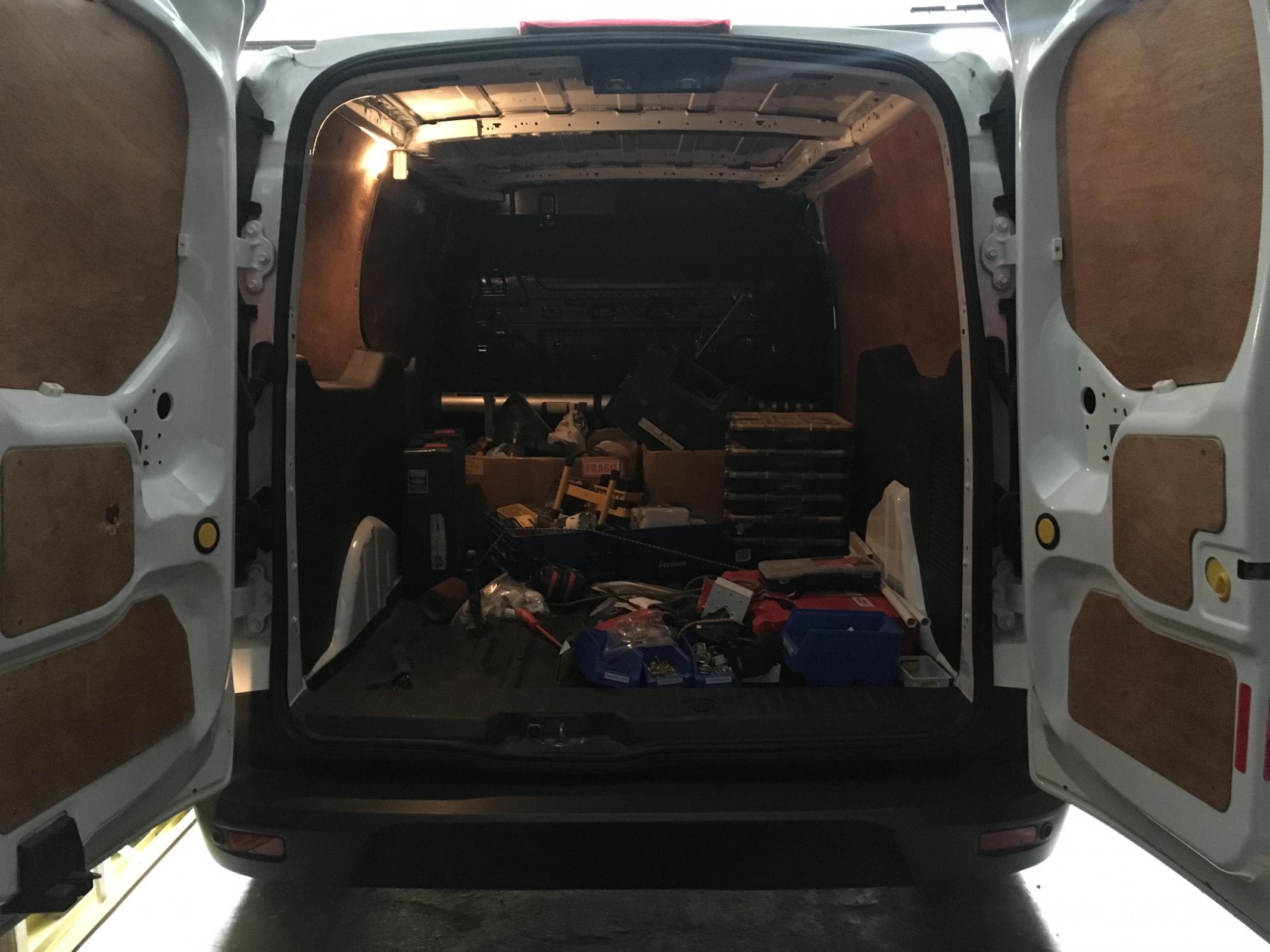

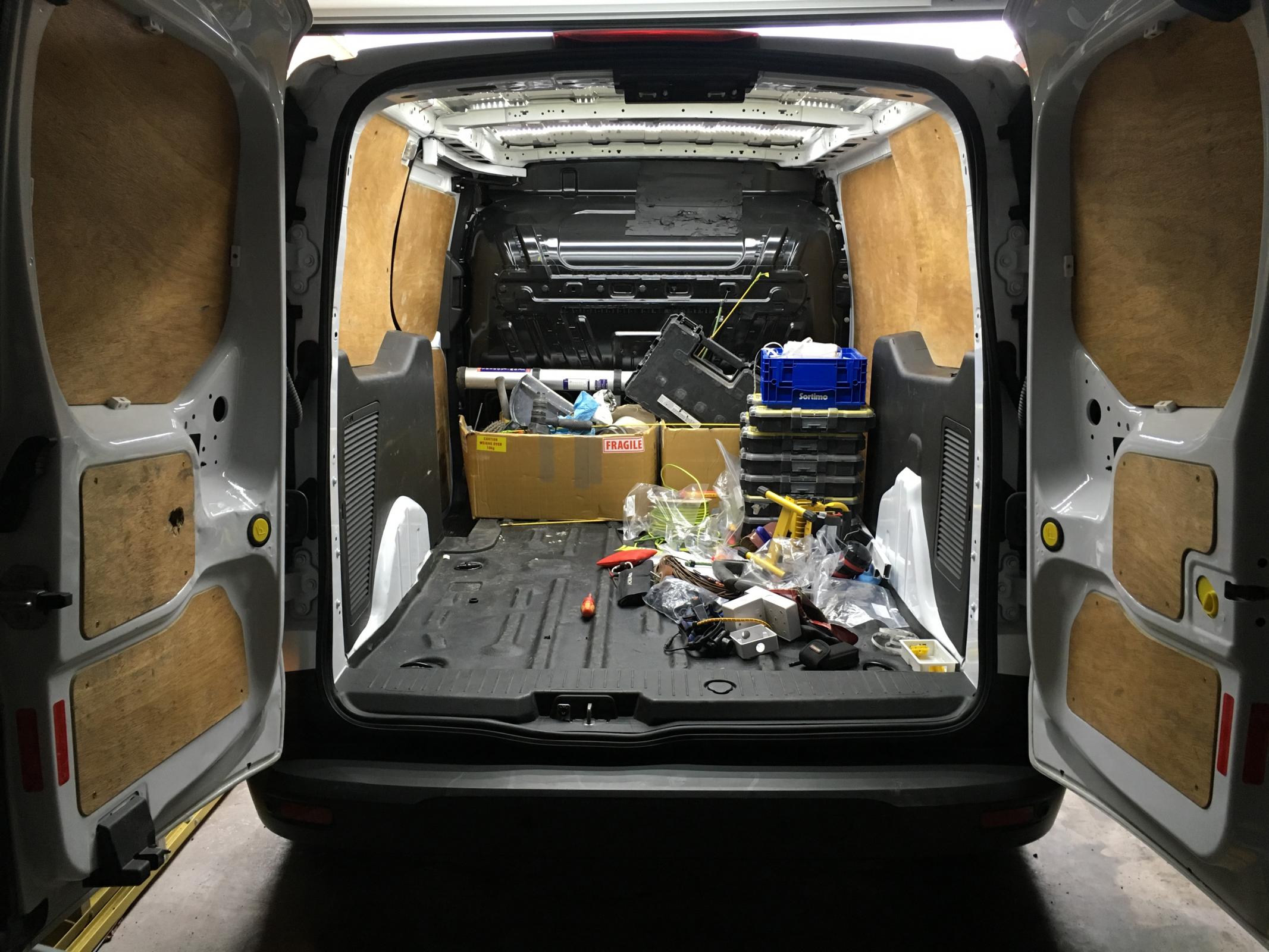

Hi,
so ive got my new van, 14 plate Transit Connect Trend 1.6 115ps with 6 speed box.
first thing is to sort the lights out in the back, see before ad after.
ill hopefully have time to pick some ply wood up in the week so I can start building some kind of system to keep things in order.
10.8w super bright led tape in daylight colour

May I ask how you powered the LEDs, please? Did you just connect them straight into the original interior light? I am looking to do something similar in my Connect. Thanks
Hi,
LED strip lights will happily run from the 12V supply to your interior light. that's how i done mine. cut the strip to length on the designated section breaks and a bit of delicate soldering. make sure you get the polarity right.

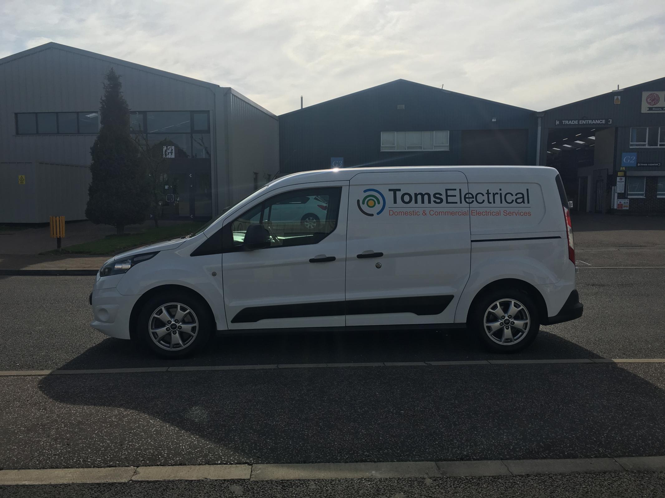

Nice van Tom. It fits in the garage then?
if signed, then get magnetic signs done.
1. when parked up, take signs off so the scumbag thieves won't think there's tools on board to rob.
2. if doing subby work, a plain van is advisable.

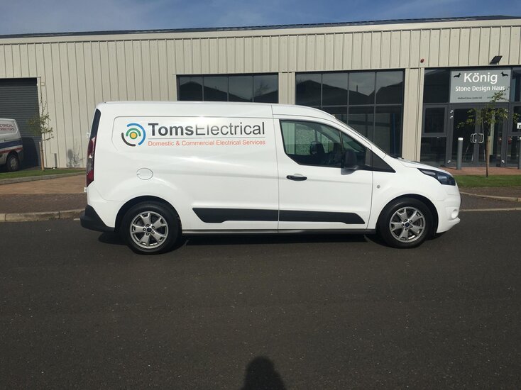

I have already put my decals on it but stupidly put them level to a laser and not to the contour of the van so will be redoing them tomorrow when the new ones arrive.
see the pic below, you can see it doesn't look correct, it's level but not in line with the panel.
you live and learn!
