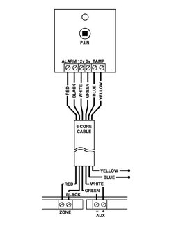

Hi, moved into a house with Veritas R8. One PIR is faulty, stopping alarm getting set. Don't have engineer codes (tried 1234, 4321 etc). How can I permanently disable the zone which is faulty?
The easiest way would be to link out the alarm contact in the PIR
Alternatively factory default the panel and then reprogram it
Thanks for information. What would linking out the alarm contact in the PIR require me to do?
The PIR will have three pairs of connections which are power + & -, tamp or tamper and alm or alarm if you put the 2 cables in the alarm connections together in one connector this will link out the PIR and once the lid is replaced if you reset the panel then you should be able to set it normally
Thanks. So just join the two alarm cables together (red and black in this picture). Sorry for several questions - want to make I don't do anything foolish!

Yes to join them just put both cables in one of the alarm terminals
Tried this today. Sadly did not fix issue. One PIR has red LED constantly on and alarm will not set (unless omit the zone when setting it). Do you have any other suggestions?

When setting it have solid red light for PIR with problem and flashing green for unset, which goes solid when press 'full'. Solid green on main box.
May just have to live with it and omit 3 when setting - which is not a massive problem! Don't fancy a full reset!!!
Thanks
Thanks - so disconnect both tamper wires for this PIR within the main panel? Everything else keep as is?
These panels have a global tamper so you will have to identify the correct pair at the panel
If the panel is setting by omiting the detector then it is unlikely to be a tamper fault
The best solution is to buy a new detector to replace the faulty one they are not that expensive at less than £10
