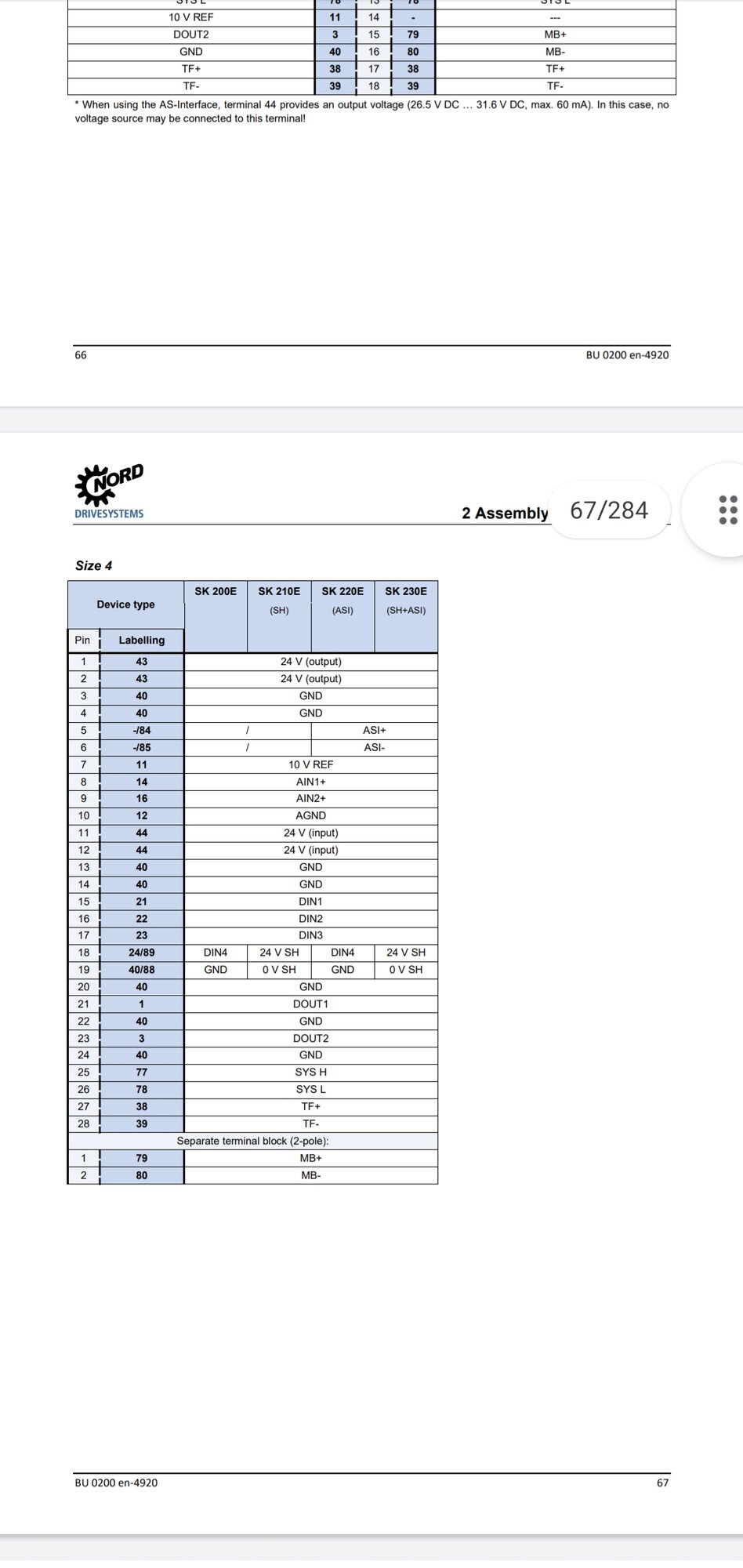

I've not worked with vfds before but have been asked to add an emergency stop button and a level sensor. Looking at the manual and reading other things online im little confused. For the emergency stop am I right in thinking i just want to break the control voltage 24v? So would i just put the em stop in series with the control terminals? The manual has 24v output terminal and things i have read say i can put the em stop in the digital input terminal, which one is correct? And would the level sensors then get connected to analog output terminals? I might be completly wrong what i said so apologies. Might be a case of turning down the job as I dont want to damage any equipment.

The guy running job is from the mainland, I stay in western isles, but he said and emergency stop, so Im assuming he has done all the risk assessments. I have just spoken to him through email. So im unsure what he needs. I will need to try contact him tomorrow and find out.
Downloaded the manual but unsure.
