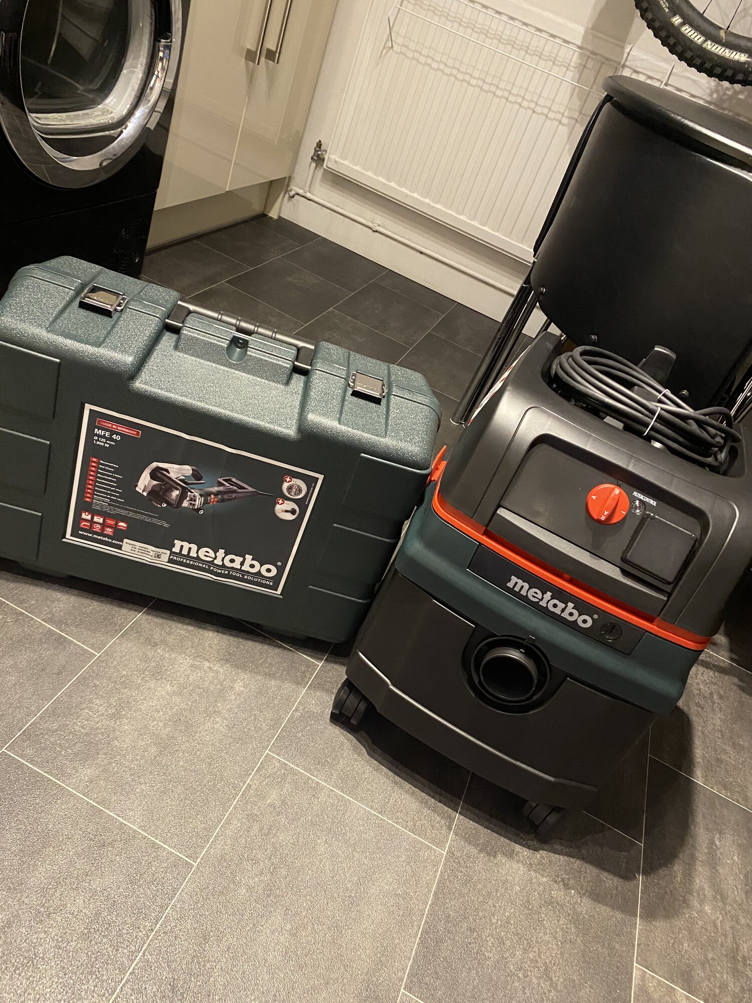

evening folks, looking for recommendations for a 240v wall chaser and extraction system.
id rather pay for quality to take the pain out of chasing and tidying up, ideally comment on chasers you actually use yourselves.
much appreciated Shane
If you are in this for the long haul and want to use it day in day out then Metabo
if it’s just for occasional usage I bought a second had sparky wall chaser and it’s ok for small jobs
no mate its long term, started on own 7 months ago so still buying start up gear. thanks for the recommendation
Miles tool & Machinery Centre have MFE40 chaser for ÂŁ344 ish delivered.
N&B Power tools have ASR 35M ACP extractor for ÂŁ410 delivered.
Prices include VAT and are for 240V tools.
Yup. Just bought the same kit. Make sure you get the triple blade, you don't even have to break out the middle of the channel. Check YouTube there are some good videos of it in action.
I have the MFE30 but that’s been replaced by the MFE40 now. I’d be going for that with the triple blade - which seems to have good reviews here.
A good dust extraction unit is just as important.
I only have the L class vac but it’s perfect for what i do, couldn’t justify the cost of the M
  • [ElectriciansForums.net] Wall chaser recommendations
I have an old sparky twin disc attached to a Henry with electrical tape
been meaning to upgrade it for about 5 years but while it works can’t part with it
excellent ill get a look, thanks
As a few of the others have said, the metabo mfe40 is great. I cant compare it to others as I have only used this one. I use it with the triple blade Metabo MFE40 240V 240V 40mm 2x125mm Wall Chaser Kit - https://www.ffx.co.uk/product/Get/Metabo-Mfe40-240V-4061792154247-240V-40Mm-2X125Mm-Wall-Chaser-Kit.
The triple blade takes out the entire chase. Also, with the dust extraction attached it virtually all goes straight into the vacuum cleaner.
I use the nilfisk dust extractor from screwfix as the price was so much better. It works, although at times it get clogged up in the wall chaser. Takes seconds to unclog, but it does make me wonder if the more expensive metabo dust extractor would have been better.
I used the chaser once without the dust extractor attached just see see the difference. I won't be doing that again.
