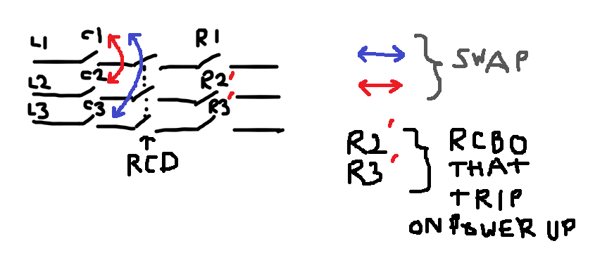

We have a race trailer in which runs off both single phase and 3 phase.
A contactor for each, which activates when plugged in, with the single phase all phases linked.
The DB has a 100ma upfront RCD incomer, then 30ma Europa RCBO's.
In 99% of scenarios there will also be a 30ma RCD on the supply to the trailer, as this is what most track side supplies have, or off generator. So there is no selectivity, but this is normal for this industry.
All works perfectly fine on 3 phase.
However on single phase it will trip the rcd in the workshop on startup.
However if i leave 2 B20 RCBO's turned off, all works fine.
Have tested all final circuits, all good.
I have also tried swapping circuits around, by putting different circuits onto these 2 rcbo's, and it is still these 2 RCBO's that trip! If there is no loading on these 2 all starts up fine.
So the problem seems to be linked to these 2 RCBO's when loaded on startup.
Is it possible for there to be a fault with these 2 RCBO's that is leaking current to earth (they have earth leads), or some imbalance?
But then why are they fine on 3 phase.... (the 3 phase in workshop has 30ma RCD).
Can anyone think of anything?, as its driving me nuts trying to diagnose!

It would be illuminating to see what happens when you swap over the incoming line contactor for one of the tripping RCBOs with that for the non-tripping RCBO. See red swap in my diagram attached.
Then restore back to 'as was' and do the same thing for the other tripping RCBO. See blue swap in diagram.
I wonder if it is the difference in dynamics of the incoming contactors causing the problem on single phase. This little test might discover that.
In my diagram I assumed R2 and R3 are the ones that always trip on power up.
Next, having restored to 'as was' what I would then do is supply all three RCBOs from the output of each contactor in turn to see what happened. There maybe something about the contacts on one or two of the contactors causing the problem.

Thanks, Will have a play with when i get to work.
The landline is 6mm HO7, around 15M long, its a 32A commando.
I did order 2 new Europa RCBO's from RS (at £40 each!), which may turn up today, so will also try swapping these over.
