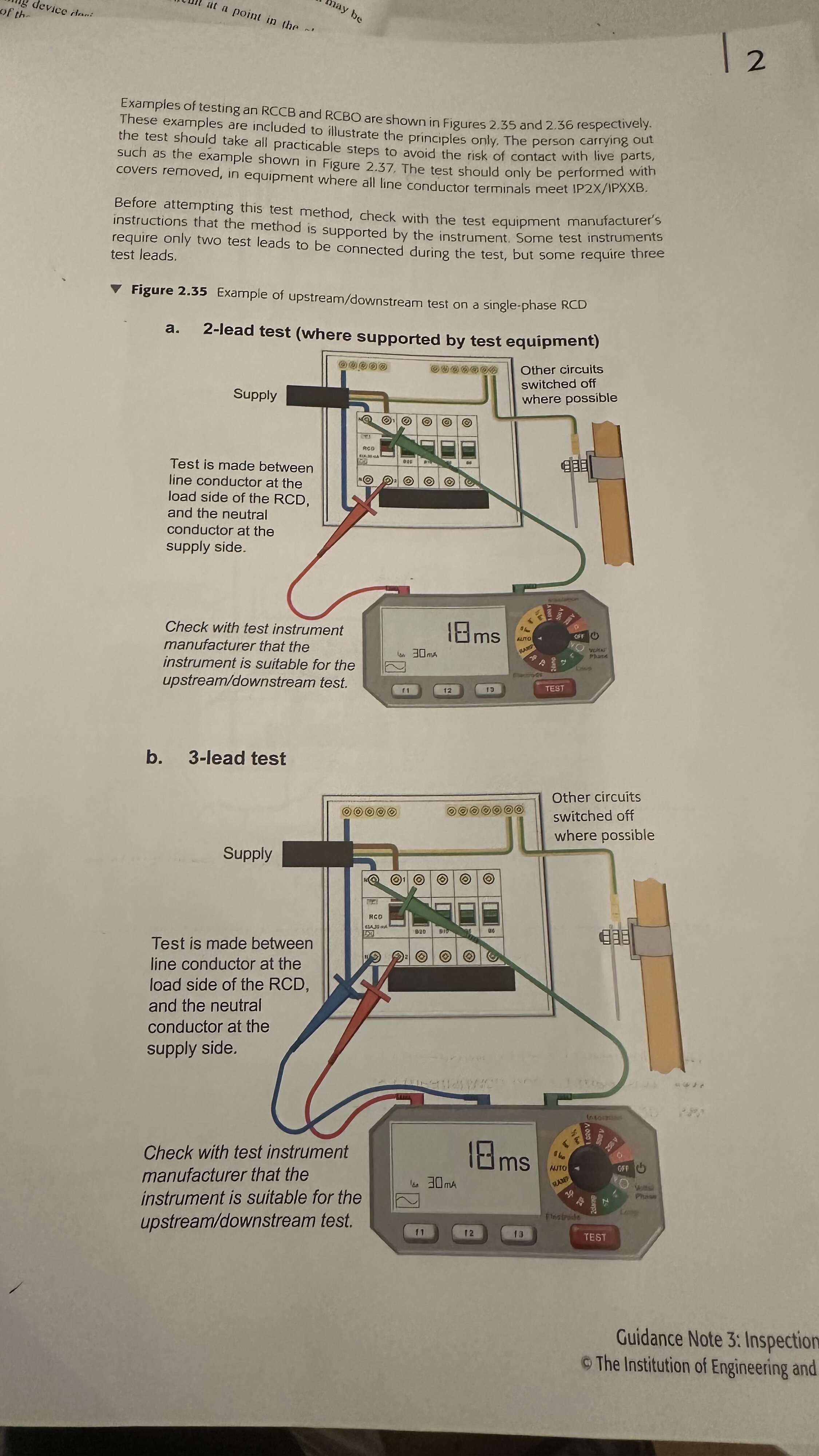

Sorry this is a bit of a long read but I’d be extremely grateful if someone can help me understand RCDs and testing methods of them.
I know RCD test applies a fault current but in what way? I understand how continuity/IR and the other test work so it helps me know what to do, what’s going on, what to look for etc but I’m a bit stuck on RCD testing. I have attached a picture which is for test method 2 both 2 lead and 3 lead)
Annoyingly there are no pictures for test method 1 but it says between line load side of that circuit and the associated cpc.
Q1.Would this be a 2 lead test only? Is there 3 leads test for method 1?
Q2.So my guess is that the instrument is probing onto L and transferring I^n at 0.5/1/5 (15/30/150ma) to Earth which then the RCD detects the imbalance between (L)-N to Earth and then trips? (Only for 1x and 5x I^n)
Q3.The instrument then detects the time it took to cut the power whilst sending that fault current which tells you the tripping times?

Test method 2 upstream/downstream method where there’s an upstream RCD like the scenario in Q5…
For both 2 lead and 3 lead I’m kind of stuck on how it stops the upstream RCD from tripping and only measures this RCD…

In figure 2.35 a, with the two test lead option this would not trip upstream RCD's as the return path is back through the circuits neutral conductor so there will only be a seen fault at the RCD you are testing.
The same with figure b, the earth lead connection is to the incoming neutral terminal, again upstream RCD's will not see any fault.
If however you were to connect the earth lead to the earth bar instead that could trip either or both RCD's as the fault current is now flowing to earth rather than the circuits neutral.

So is what you’re saying about using the neutral as a return path the same as what I was saying of the imbalance only being measured on RCDs load side?
Figure 2.35a it’s measuring the imbalance of the outgoing L to the incoming N and the upstream RCD doesn’t see the imbalance of L as L is part of the load side of the upstream RCD as well as the neutral so there is no imbalance so therefore upstream doesn’t trip?
But it will see an imbalance of the RCD we’re testing because it’s sending a fault current from the load side L back onto the supply neutral and it’s registering that there is a loss of balance between both L and N on the supply side of the RCD therefor it trips?

Yes on Method 2 this is what happens. The RCD only sees what is downstream of it. Method 1 and 2 have pros and cons which you will start to make sense of knowing when to use which under any given set of circumstances.
This method of using line and Neutral is also, in effect, how the RCD integral test button trips the device. When you think on it the test button does not use the cpc to check the mechanical operation of the RCD (how can it) and will not trip if the device is not powered to the correct voltage.
