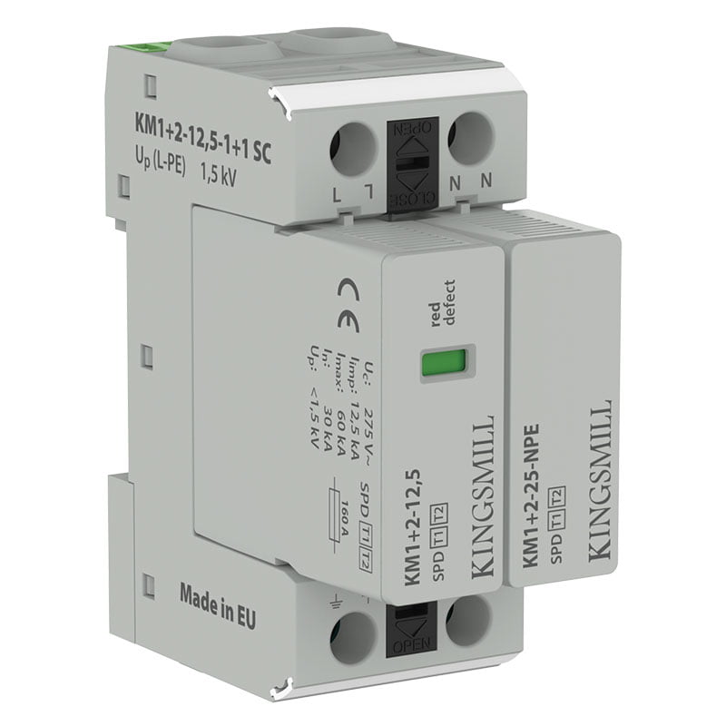

We were all told that SPD's were mandatory under A3 from September last year and even sat through the webinar spelling it out. I work an area with lots of overhead lines, I ran out of the Type 1's I bulk buy online and could not find any local wholesalers who stocked them (type 2 yes but no type 1). It seemed strange that it is now mandatory to fit them but you can't buy them at the wholesalers.
Fast forward a few weeks and I am sitting in an Aico fire alarm training session and I raise this point afterwards with the trainer. His response was that no one stocks the expensive Type 1's because they aren't mandatory, they realised that making it mandatory was a stupid idea and they pulled that amendment.
So what is going on? Did they pull the amendment? Is the amendment still in force but being largely ignored? What's going on with this...

Type 1 is purely to arrest lighting strikes and according to the manufacturers type 2 won't do a thing to arrest a spike from lightning. That said the grid are required to have lighting arrestors on the poles every 500 meters so a strike would have to be incredibly close to get to the home. If it was that close would a double width module on a DIN rail really arrest that much energy? I very much doubt it.
I will have to ring Napit on Monday when I get chance but it seems very strange that no one stocks Type 1's in an area that has masses of overhead lines.

@loz2754, Type 1 SPD's are also required for overhead supplies. See How to choose an SPD - Surge Devices - https://www.surgedevices.co.uk/2346-2/
