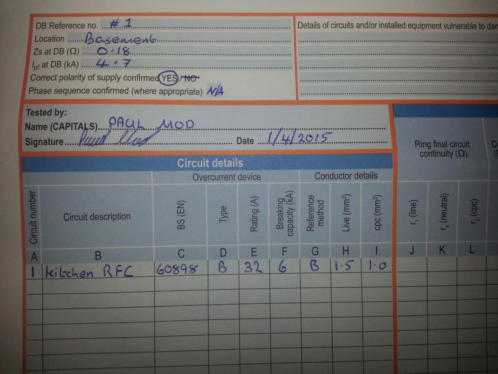

I'm going to post up the worst schedule of test results you will ever see! Build it up bit by bit and discuss the things that are wrong with it. Here is the first part, 3 things wrong on it (apart form the date, thats just me messing about).
[ElectriciansForums.net] What is Wrong with this Test Sheet?
Post up what you think is incorrect and why. I'll add another part to this schedule of test results later in the week.
Its a 1.5mm cable protected by 32a breaker. 32a breaker will not be sufficient to protect the cable. Fire hazard.
Half way there mate. 1.5mm RFC????
Breaking capacity exceeds ipf?
Erm... no.... May need to do the calcs on this one? We have the Ze, the ipf @230V nominal Voltage. Why is it wrong on the test sheet??
Im confused now mate, is the IPF wrong or is it the PSCC reading? which would make the Zdb of 0.18 irrelevant to the recorded 4.7Ka. :)
Does the 1.5mm2 require OL protection or due to the nature of the connected loads is just fault protection required?
Ok cool, 230/0.18 = 1278A
Just wondered if maybe it was the PSCC reading as it could be higher than the 1278A PEFC. Phase sequence not applicable though so doubt it would be that high.
1.5mm2 is not suitable on a 32A (unless it was MICC perhaps)
