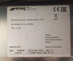

Customer has a smeg sy921px8 symphony.
On line it looks like it is 15.8kW, but if you look at the rating plate in the picture it looks like it is less than this!
In the picture it has a squiggle then says 12.5kW. Is this the total rating of both oven and hob? Just seems weird it has the hob rating, then total rating but not oven rating.
The reason for the enquiry is relating to the cable size I will be using, 6mm or 10mm.

Even if it's 'only' 12.5kw you're into 10mm cable anyway so not sure of the dilema?
I think the difference in rating is due to the Booster function.
I'm not sure if it's a Smeg thing or whether it came up on a different make, but has been discussed before, an owner was complaining about the reduction.
Although the Booster can add 2.2kw to the front left hob I believe it does it by reducing power elsewhere if the Hob / Oven is in full use, so the max use never exceeds 12.5kw.
6.0mm cable ref.C has been fine upto 15kW for donkeys, allowing for diversity. never even hots up a 32A MCB above warm.
6mm rated to 46A - 12.5kw being 53ish. Totally agree with you practically, however.
You could probably shove 100a up a 6mm and it wont even bat an eyelid
But following the regs for a 12kw load i would fit 10mm
I believe this actually includes a 5A allowance for a socket too. My diversity calculation suggests that without a socket, A 32A circuit will power up to 19kW of cooking appliances:
(32-10)=22
22/0.3=73.3
73.3+10 = 83.3
83.3 X 230 = 19159W
Like some of the replies above 12.5kW is fine on a 6mm with diversity, whereas 15.8kW is pushing it.
I'm a bit surprised at all the suggestions of 10mm when only 12.4kW. Do you guys not apply diversity as in the OSG?
