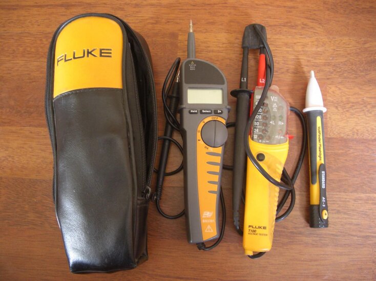

Here's mine ,all in the one case in the bottom of my tote.
