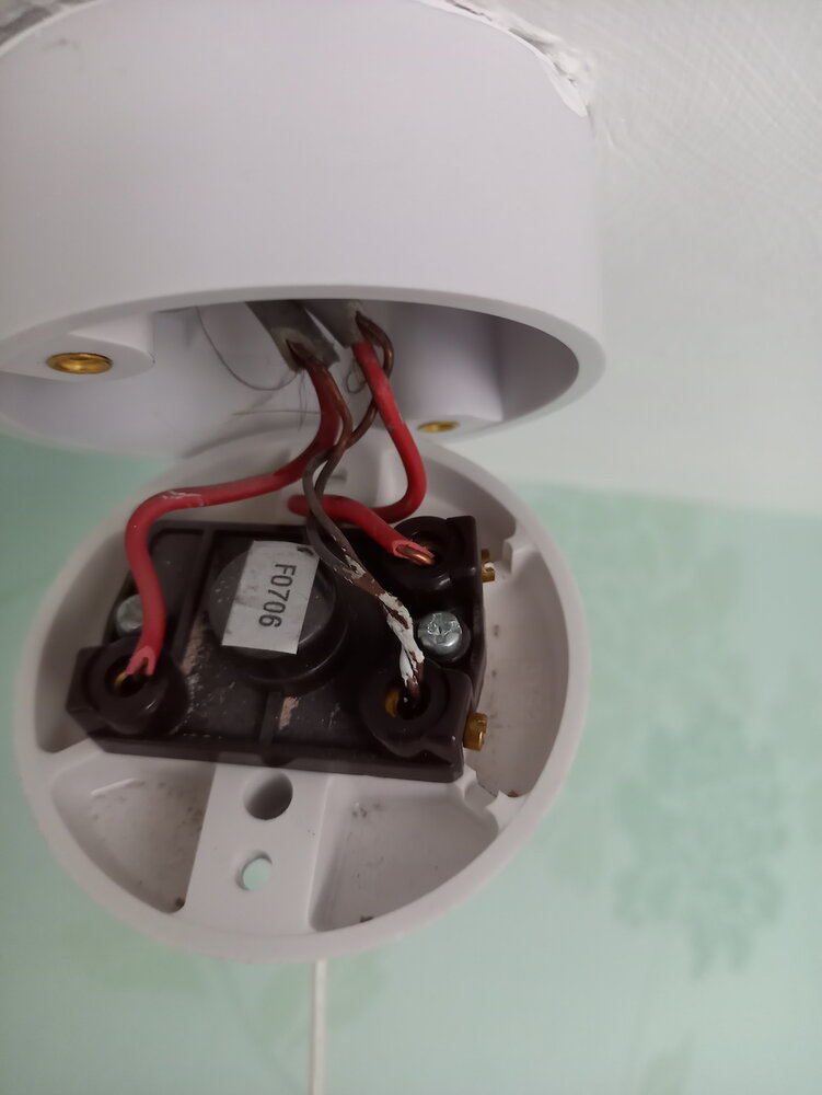

I'm familiar with RCD spurs giving readings of 0.1 to 0.3MΩ when testing insulation resistance (L+N tied together to E), but what would give a reading of about 65Ω (when tested with "low resistance ohmmeter" i.e. continuity setting) N-E? On a lighting circuit - N isolated from other N's protected by the same RCD, and just for good measure the (double pole) RCD turned off (so if there's a borrowed N with another circuit, N on the circuit is still isolated from E at the PME block). RCD tests out fine, no reports of tripping.
I'll admit I didn't clamp L+N to see if there was actually any leakage... my working assumption is that this is an AC/DC thing - in the same way that if you measure the resistance across L and N when there's a transformer in the circuit (e.g. a shaver socket) it gives a very low reading, but it draws nothing at 50Hz.
I couldn't see any RCD spurs, but that doesn't mean there isn't one buried away somewhere... any I've never had a strange reading this low before.
What could it be?!?
Cheers :)
65 ohms is likely to be a fault where N and E are just barely in contact with one another. This might not trip the RCD if it's near the DB, especially on PME, because as radiohead points out there might never be enough voltage drop along the N conductor from DB to fault to drive 20+ mA through it.

At 65 ohms you would need 1.95V between N & E at the origin to cause 30mA, so if the voltage is generally below 0.975V (which is likely in a TN-C-S setup) then you won't see enough earth current to cause a trip.
However, in many cases what you will see if it tripping unexpected when you have, say cooker on and shower in use, or vacuum cleaner started, and the peak demand goes to 60A or so then you would see that sort of voltage if there was a total of 16.25 mOhm resistance between the neutral bar in the CU and the combining point of the PME N+E.
That sort of resistance is rather high for that part of the installation, so unless you have very long tails (17m of 25mm, for example) and/or some dodgy contact resistance, it is not going to show up routinely.
Found it (65Ω partial short N-E)... you're gonna love this... :) :
[ElectriciansForums.net] What would give a low N-E resistance (at DC), but not cause the RCD to trip?
:tearsofjoy::tearsofjoy::tearsofjoy::tearsofjoy:
Given the white paint on the bare cpcs, my money is on the decorator.
Genius!
Genius!
where's the Neutral? looks to me like a 2 way pull switch so what's the cpc doing in the swiych terminal?
