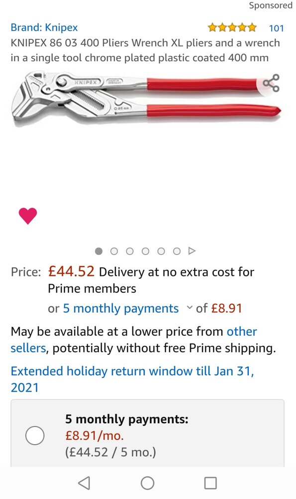

Hi everyone,
Just wondering what tool do you all used for gland bigger than M63? I'm using stilltons but I rather not used that as they mark the glands. Any suggestions would be great thanks.
I've seen the ridgid offset hex wrench they look like what I want but the Jaws max up to 67mm. Is there anything similar with bigger jaws opening?
knipex have an xl version of the pliers wrench That open to 85mm, I have a smaller set and they are my go to for not marking glands as the jaws are flat and open parallel,
ETA
ÂŁ105 on amazon
Rigid e110’s.
Rigid e110’s.
Thank you for your post. I have seen that but the jaw only goes up to 67mm needed something bigger. Like the knipex xl wrench
Bargain down from ÂŁ105!!!
