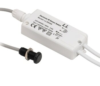

Hi all, hopefully you can see the image of Electronic IR sensor switch on it is a circle with a X in it two lines trailing from it with two dots at the end
I understand they may be (lamp or directional) symbol can someone please clarify... I supplied it to a colleague to power a low voltage strip ( he blew it up ) the literature for the unit says :

I'm not sure how he has wired it until I get to job tomorrow but I suspect he has used the output terminals as a switch (Same cable either side of terminals) so he tried to explain.
I thought the output would be 230/240V which in turn would power the driver/transformer..

Feed in on left cable,feed out at right cable. Output at 230 volt so a transformer needs to be connected to it on the output side,did he connect mains out direct to lv fitting.
Many thanks pal, sorry for late reply I aint been well. Yes your correct and I did explain this to my mate, but he was convinced that the symbol meant it was a switch... I think he's loosing it because he managed to blow up a dimmer switch yesterday, he is getting on a bit now might be time to retire him....
