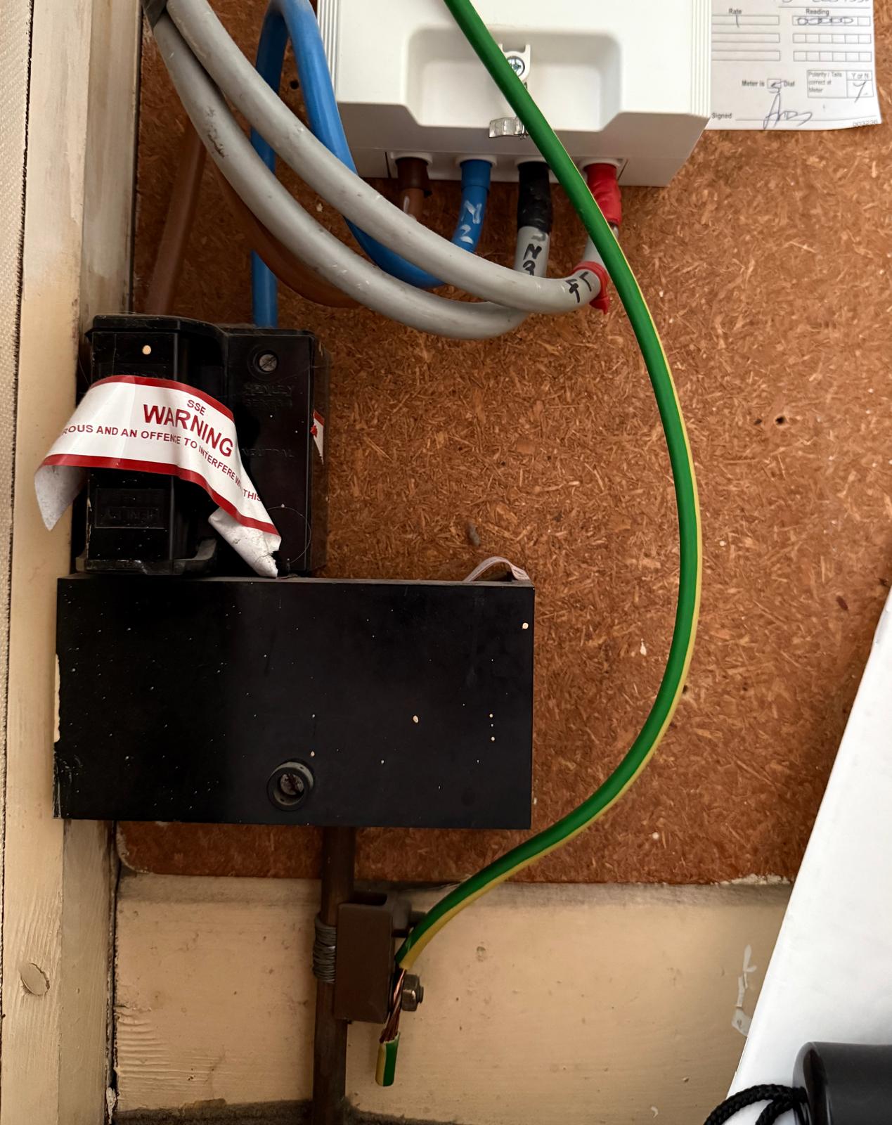

Adding picture of the existing gland which joins my main electrical power box.

you say a 2H10, @westward10 ?
That’s a 2 core, 10mm? So I think this could be a main supply cable feeding the property?
OP, can we see what the MICC is connected to?
It's an old house which was divided into 5 flats in 1959. The black box (pictured) is where the power comes into the building and is separated for the 5 flats. The gland (pictured) is coming out of that black separator box. The last picture is the MICC cable coming into my flat, however, that is not the cables in question. The problem cables are the two which run through my flat to the 2 above flats. The picture of the gland which I posted earlier in this thread is what the electrician saw when he opened the connection box coming into my flat.
So it is the main supply cable.... to the flats above you
You will need to get the supplier/ DNO involved to isolate the cable before working on it, and resealing the fuses afterwards.
Its a little more involved than just getting an electrician in.
The warning stickers and seals are there for a reason.

The pot and gland sizes are nearest equivalents from a Pyrotenax you will see the gland and pot are 1H50 and they state the pot must be soldered. Metric equivalent of a 465 cable is 6.45mm².
Thank you for pointing that out. I presume the electricians have taken that into account but I will check with them.
