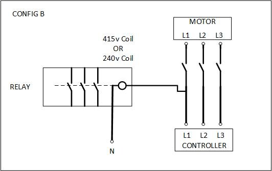

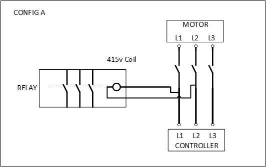

I Have a little question not sure which way is correct see images
[ElectriciansForums.net] Which way is correct - Relay wiring..
I need the coil to be switched when power is supplied from the controller to the motor switch. The relay will be switching a 24v DC feed to a Warning Beacon & Siren.
Not sure because controller doesn't have a N output weather I need to use a 415v coil or I need to feed the coil with a N feed. If the coil is to use a N is it a 415v coil or a 240v Coil?
Both wiring methods are correct as shown but as for complying to regulation would depend on your control circuit and how its layed out...
What is the controller ? Is this a VSD or a contactor?
What existing control voltages exist? Is the 24v you require for the Siren already wired or are you fitting a DC supply.
What is the duty of the motor (what job does it do?)
What is the purpose of the Siren? ... Is this a safety/warning set-up?
We need a lot more info here because you are altering or making additions to a motor control circuit, you may be restricted by regulations if the existing set-up is part of a larger control system then give as much info' as possible.
Lastly - Welcome to the forum.
