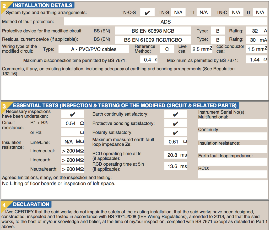

Since we're sharing redacted MEIWCs, here's mine (have removed the MFT S/N, was filled in):

I notice you've got a type B RCD too... :)
I'm just a trainee so had nothing to do with it. Had a mooch, practice for my 2394/5, I have a broken ring: one socket in the kitchen is on one leg, everything else (including the cooker) is on the other. I left a message on their answerphone last week, no call back. Have emailed them giving them the opportunity to put it right, we'll see what happens. In the meantime I've swapped the 32A MCB for a spare 16A, and am avoiding boiling the kettle, cooking, microwaving and running the wall mounted fan heater in the conservatory at the same time for the time being.

Hi Steve
If your using this for practice remember LIM is only for EICR not MEIWC but I bet you picked that up on your studies>
Good luck

Follow up on this: bloke who owns the company phoned me up this morning and came round this afternoon. Lots of apologies. Said bloke who did the work doesn't work for them anymore. Ring restored - break probably a result of plasterer filling in a back box (we did wonder at the time why we'd got one less socket than we asked for!). All good :)
He really was very apologetic, and rather embarrassed.
