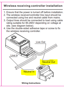

anyone point me in the direction. customer wants 7 wi-fi control switches to be on an app. with phone. no neutral at switches. he's looking at these:
hoewver his existing switches are on a 25mm galv. box in brick walls. the above need 47mm.boxes. is there anything out there to replace the existing switches and still fit on a 25mm box? otherwise, it's a lot of work and mess chasing for deep boxes.

LightwaveRF doesn’t need a neutral but would need filiment type lamps.
Also needs the expensive gateway to connect to Internet hub.
I also think they need 35mm boxes.
What about a 10mm spacer behind the switch to bring it off the wall a bit to give more space behind.
looked into that. would need at least 15mm spacer. would look horrendous. time to get the chisels out.
I'm obviously missing something here the unit is 41mm x 36mm x 17mm so unless there are multi gang switches why does it need such a deep box
device is 17mm thick. 25mm box. switch takes up 15mm. that leaves 10mm space behind switch, not including a bit of space for conductors. might be possible to cram into a 35mm box, but why cram if i have to chase anyway.?

The Lightwave switches come with a spacer/bezel, which the faceplate sits in, so doesn't look bad. The spacer gives an extra 7mm clearance. The screw terminals are accessed from the top of the switch, and where the cables enter is stepped away from the back. There is space to run cables around the sides of the central module if you have enough length. I've just measured one, and using the spacer, the module itself protrudes just 18mm into the back box.
