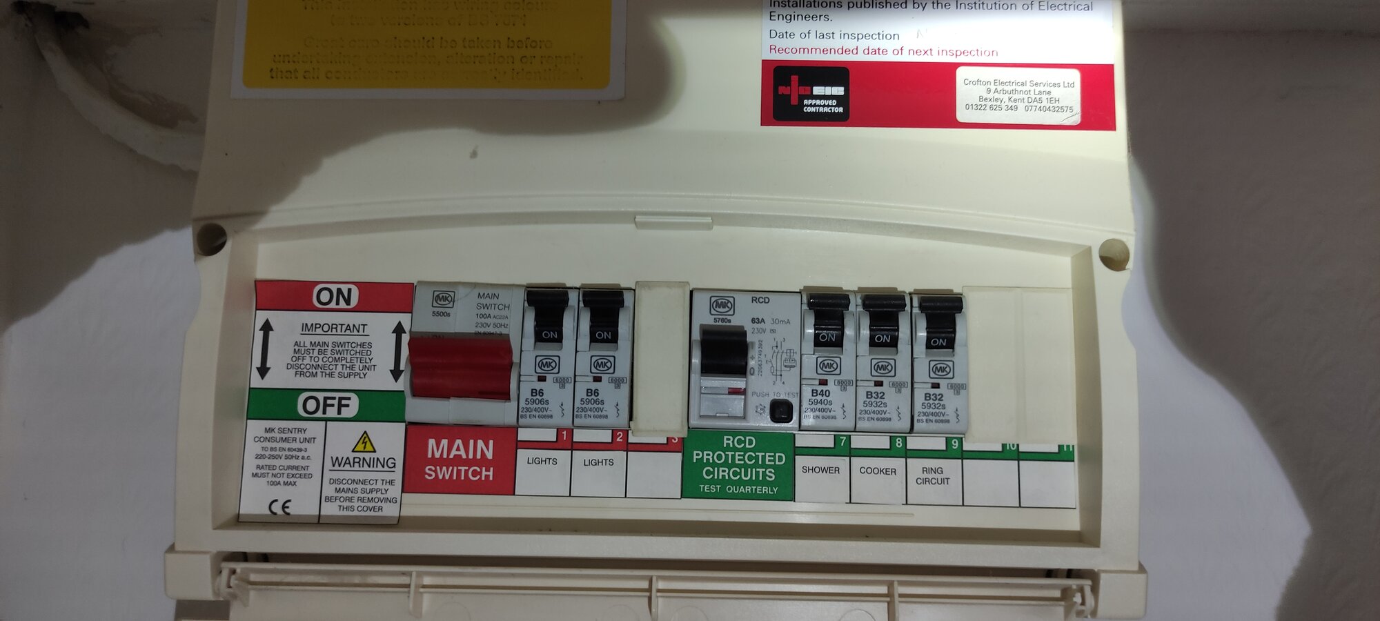

I want to change the 3 MCB's in the picture for RCBO's.
Will the MK ones fit?
Cheers ?

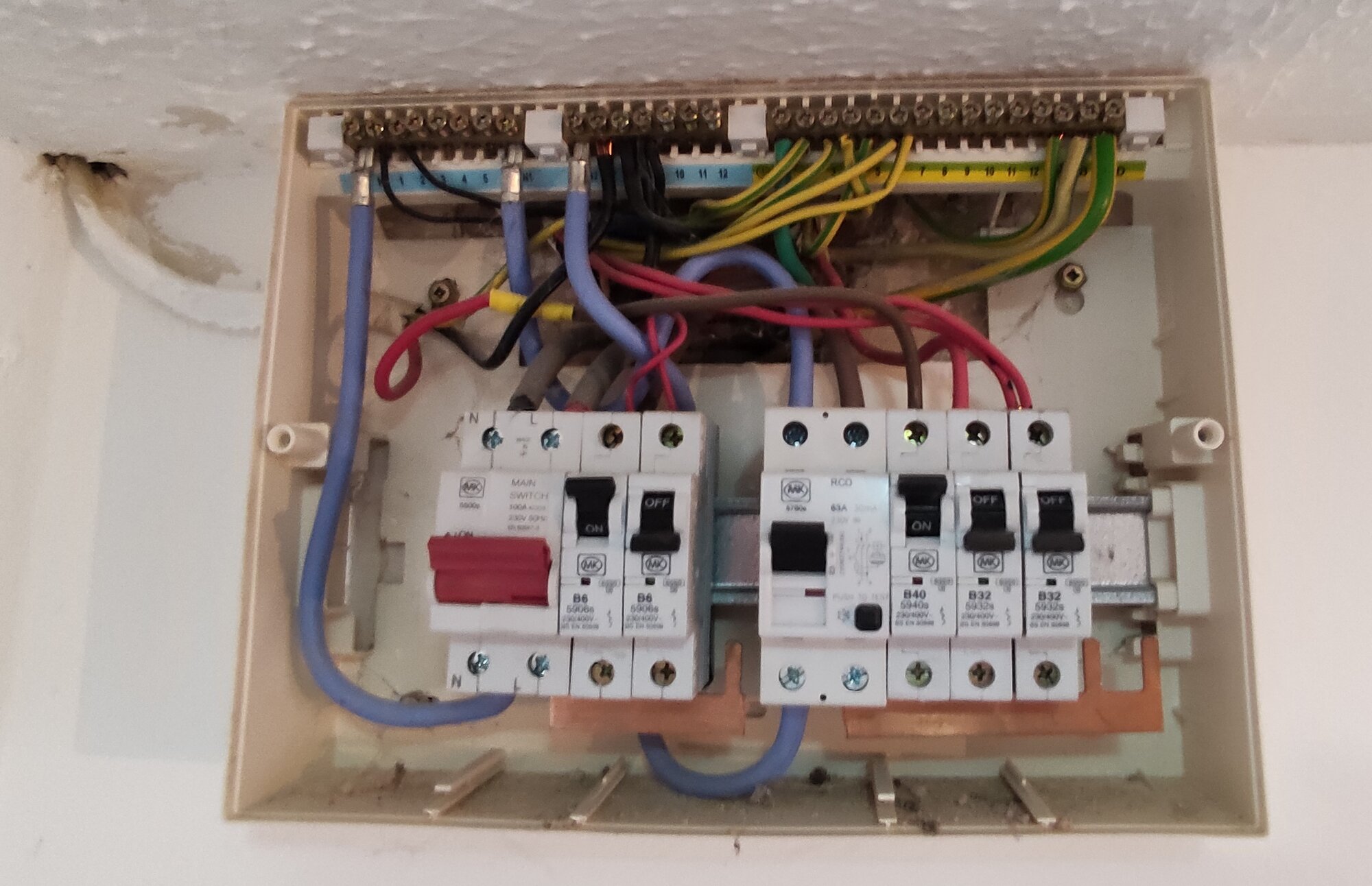

So will this one fit. New from screwfix..
There seem to a be a few different product numbers for them. Is there a specific product number that will fit my board? They either start in 69 or 79, will both fit?
I have researched a little more and there are quite a few threads on other sites that say the MK RCBO's (69 and 79 designed for sentry 2 CU) need a retrofit kit in order to fit in the older sentry boards with the 59 MCB's in them. In other words they don't fit. Are you sure they fit @westward10 ?
There is also some talk that a wylex RCBO fits in the 59 sentry boards?
why not just buy 3 new circpro/mk rcbos and a new main switch at same time? as the RCD is fed via a fly lead inside? can use a busbar of choice then. dont have to worry about alignment between rcbo / main switch as all will be of the same version so align perfectly.

The only retrofit kits I know of were for the original Sentry boards which had the devices incorporating a slider type switch like these.

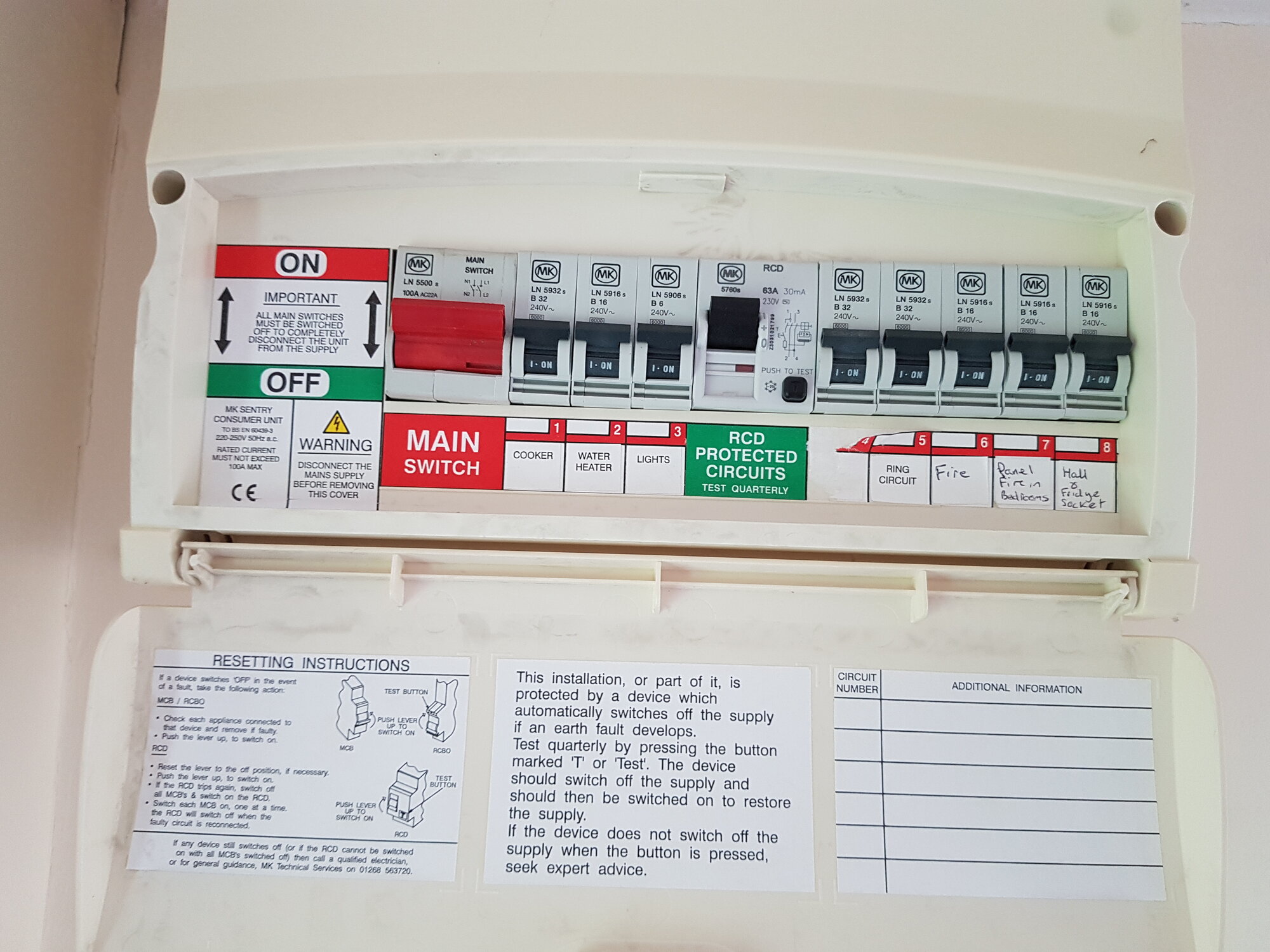

I replaced a 6A in a board that I believe was this vintage fairly recently - it was MK old stock, bought from TLC and went in with no problems at all.
I believe the new Circpro are identical, except that they are now available in Type A.
Edit: - just looked back and my one are the slightly different layout (newer?), though same model - 5906

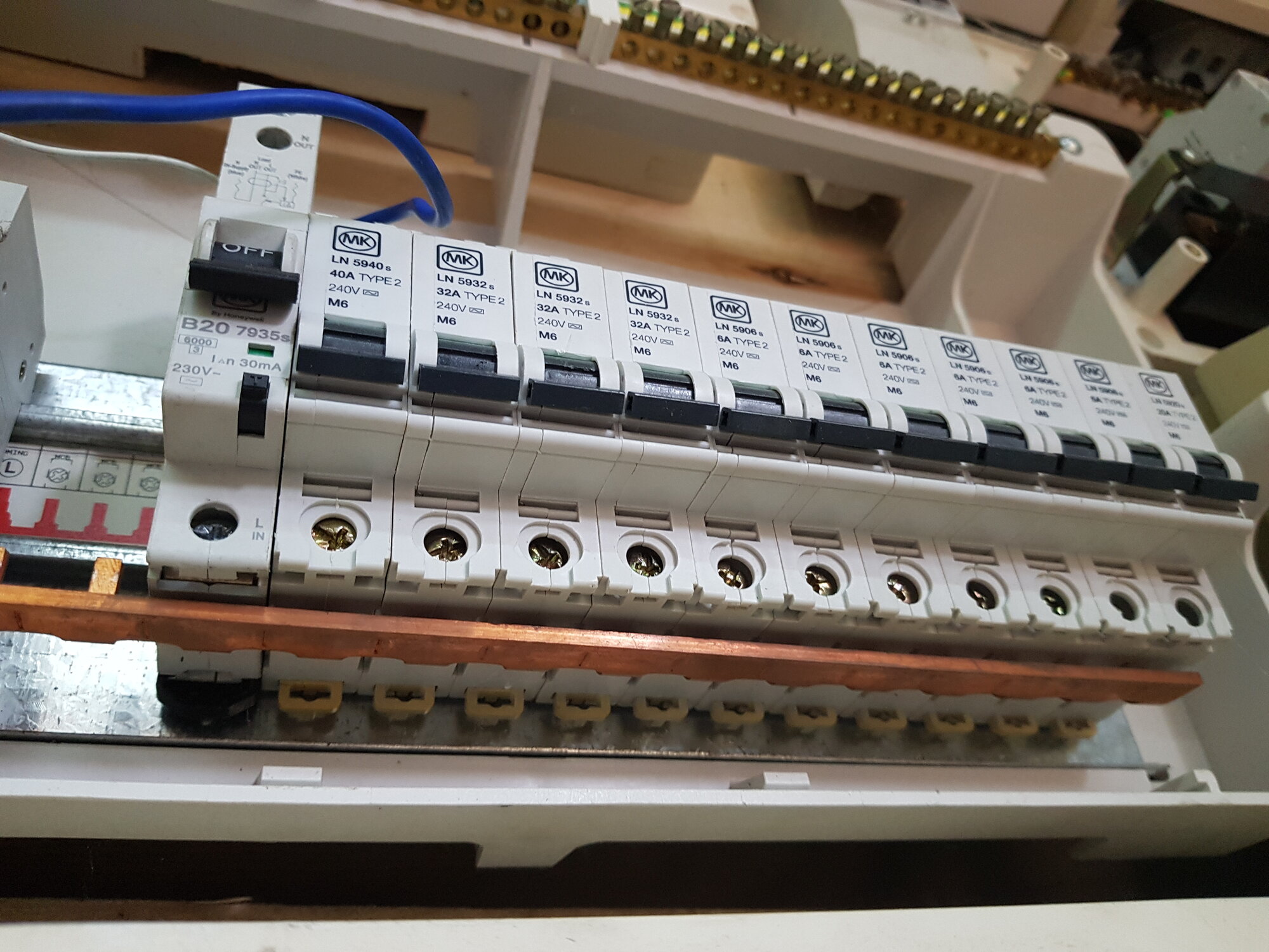

The one I bought was MK7932S - this one, which fitted my board with no issues at all... Type AC was the only option at the time, but looks like the new Type As are now available....
[ElectriciansForums.net] Will an RCBO fit in the MK board?
This was the existing setup - I replaced the 6A for bathroom lighting/upstairs.
Thanks alot Dartlec, I'll give it a go ?
