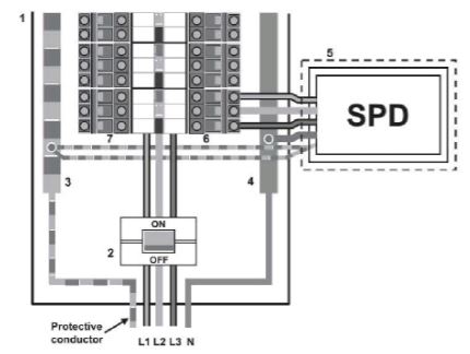

can any one clarify if a SPD will now need to be installed when making an addition to a existing circuit? many thanks

After listing the 3 situations where SPDs must be provided, the regulation (443.4.1) goes on to say:
"For all other cases, protection against transient overvoltages shall be provided unless the owner of the installation declares it is not required due to any loss or damage being tolerable and they accept the risk of damage to equipment and any consequential loss."
What it doesn't give any guidance on, is whether adding to a circuit, or adding a new circuit, would mean we would have to add one or more SPDs. This is where many of us would apply the previous guidance that was given, relating to whether an RCD would need to provided when altering or adding to an existing installation.

You can get from Wylex or Proteus an inline isolator and SPD, as its inline rather than parellel the length of conductors for SPD's is much easier to meet. I would say as its part of an isolator and not that big you could put it in the meter cupboard, so this might be a good solution...
It is made quite clear an SPD is required for a new circuit, there are solutions like above which will mean you dont have to replace the consumer unit, there is also a get out in that the customer can refuse... I checked with NAPIT and they were ok for me just to put on the EIC under departures of BS7671 that I have talked to the customer and they understand and accept the risk and have refused an SPD... Just give the customer the option, if they take it then great a little upsell, if they don't then just mark it as a departure.. I would say though if changing the consumer unit, I just would not give the customer a choice but I can see if say you wanted to add a circuit of a 16A mcb to provide a socket say under the stairs next to the consumer unit, adding an SPD could more than double the cost of the job, but put that decision onto the customer, I personally think that is why they added the get out clause of a customer refusing...
Maybe if I could get more excited about SPDs adding value I'd be more willing to fit them in their own enclosure. But thinking about it, there are some requirements regarding lengths of conductors for SPDs that I'd have to look up again, and last time I looked into it it wasn't trivial to achieve.
Regs state the total length which is the line length from the OCPD to SPD + CPC length from MET to SPD should preferably not exceed 0.5m but in no case exceed 1.0m
Virtually impossible to achieve under 0.5m in an external enclosure and very difficult to achieve under 1.0m
Even internal SPDs can be difficult to achieve within these limits for a 3 phase board
My understanding was if you put it inline then the length is the cables inside the board... Check out David Savery video @ 18mins..
I could be wrong but that was my understanding..
Yes inline is fine because everything is in the enclosure
I was referring to retro fitting to an existing board as in BS7671 illustration
