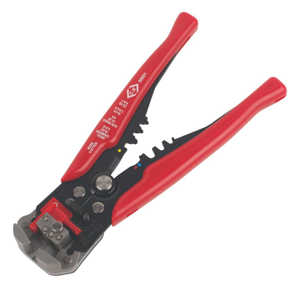

Anyone have a set of these or similar?
I have a set of these ones...
...but like the idea of being able to strip the cable head on so as to be able to strip more of the outer sheath when a cable is already inside a backbox/fuse board.
The ones I have leave quite a bit on as you have to have the strippers sideways for them to work meaning more space required.

Some love these, some hate these - I think CK crops are the way to go BUT you need a year of so of regular use to master properly. The more complicated the stripper the more to go wrong....(I do mean for wires here) is generally what I find marks out the more worthwhile tools. (note - By CK crops I mean the red handled very sharp ones, not side cutters)
CK T1260 will get further into boxes, but not really as far as you might like in 1G or deep boxes. I like auto strippers, but they rarely come out of the box unless stripping a lot at one time - pocket space is limited and other tools that strip perfectly well are always in them (knife, side cutters and shears/croppers).
To be fair, I don't often work with the flat cables these auto strippers work best with and tend to use shears or knife on round cables.
I have a couple of automatic wire strippers, like the CKT1260, and one like the CK 10 1/4, but, like nicebutdim, they rarely get used.
99% of the time I use strippers like these: https://cpc.farnell.com/duratool/d03424/4-cable-cutter-stripper/dp/TL21086 , and then stripped down with the spring and adjustable stop removed. I use them with one finger between the handles, which serves as both spring and adjustable stop.
Experience tells me exactly where to slide my finger, without any conscious thought at all, so that the insulation is severed without ever marking the copper.
That's pretty much the same principle as stripping with larger CK shears.
I use the CK auto strippers a fair bit, but agree that for back-boxes they dont really get right into the box far enough due to having to be used "side -on". I "knife" the rest...
One thing I have noticed is that the red handles can slip off the metal bits, which is very annoying, so need to glue them on if yours are slipping. Also, if you have used lube to pull the cable then they simply slip unless you tighten the gripper thingy...

I've had 2 pairs of the 1260 strippers, and I love them. But they don't last very long before the blade breaks, and the replacement blades cost almost as much as the strippers.
I mostly use my NWS side cutters now.
For round cables I use the Knipex Ergostrip, which is a brilliant tool, even for 25 mm tails.
I had the jokari equivalent of the 1260. I don't think they were ever right even from new though. Sometimes they'd work correctly, other times they wouldn't grip the cable, other times the grip would mangle the insulation. They got thrown out and I just use my CK side cutters now.

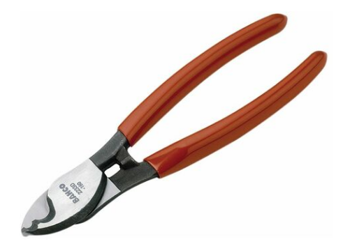

I have a pair of CK strippers, but owing to arthritis I have found Bahco 2233D-180 to be the best yet, amazing how sharp & lightweight in the hand, will cut through 10mm like butter. they are 160mm in length but you can get larger ones.

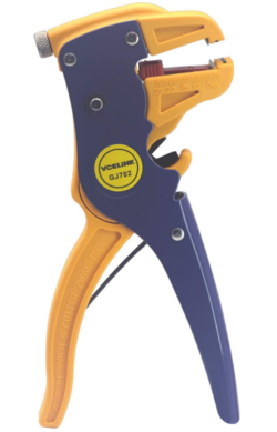

Also found these Vcelink that may help to stip in backboxes, look to be cheap & cheerful but I think I will order a pair at £11-99.
