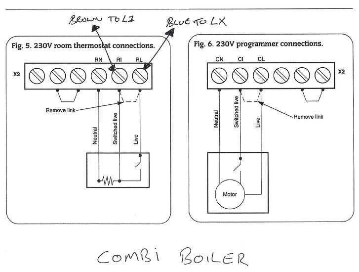

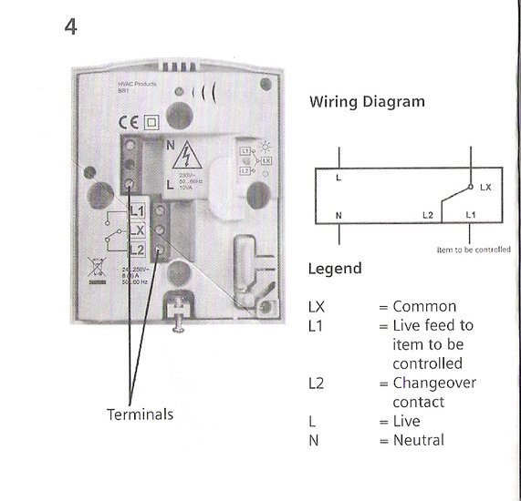

hello to you all
i have a combi worcester 24i rsf i have wire in a boss therm bps242rf but when i set the timer to come on the boiler will not fire up, when it is cold it will fire up and when it reaches its temp it will switch of, can you look at the pitchers and tell me if i have wired it correctly
thank you in advance
