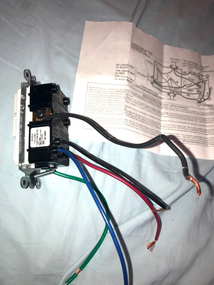

Before you write go get an electrician - I HAVE! And he's never wired one before. AND asked ME to do some research!! Before you also say get a new one - though boy do I want one - it is a long story and not an option.

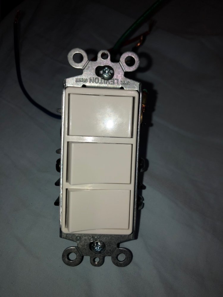

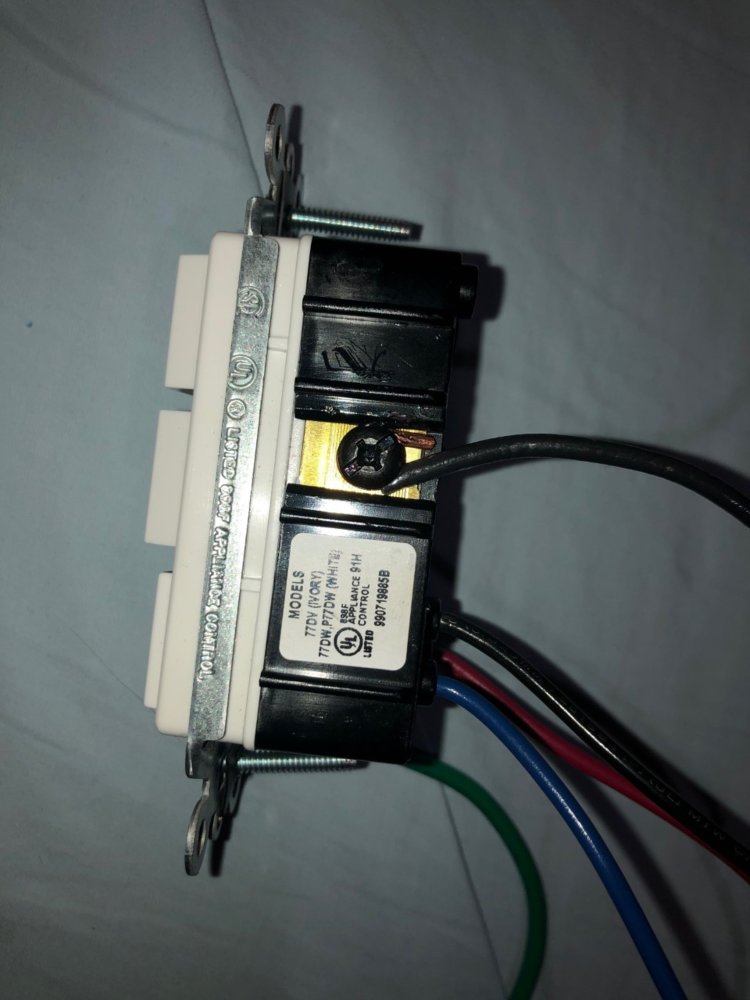

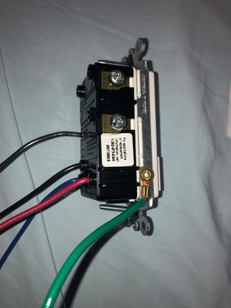

The switch is to control a bathroom vent fan with an inbuilt light, nightlight and heater - hence the 4 functions. Two switches are normal on-off for the fan and heater, whilst the third has a rocker position to accommodate the light, nightlight and off. Love this switch option which controls all the functions whilst only using 1 gang, so separating it into 4 different switches is something I won't consider (he suggested this option).
The wiring diagram shows three loads going into the junction box, but the electrician has 4 wires for each function coming out of the vent unit. Perhaps the two light functions need to be spliced inside the junction box before connecting to the switch? He doesn't seem to know how or where to integrate the 4th function.
Anyone have any insights? They would be MOST appreciated so I can get back to picking out my sconces
