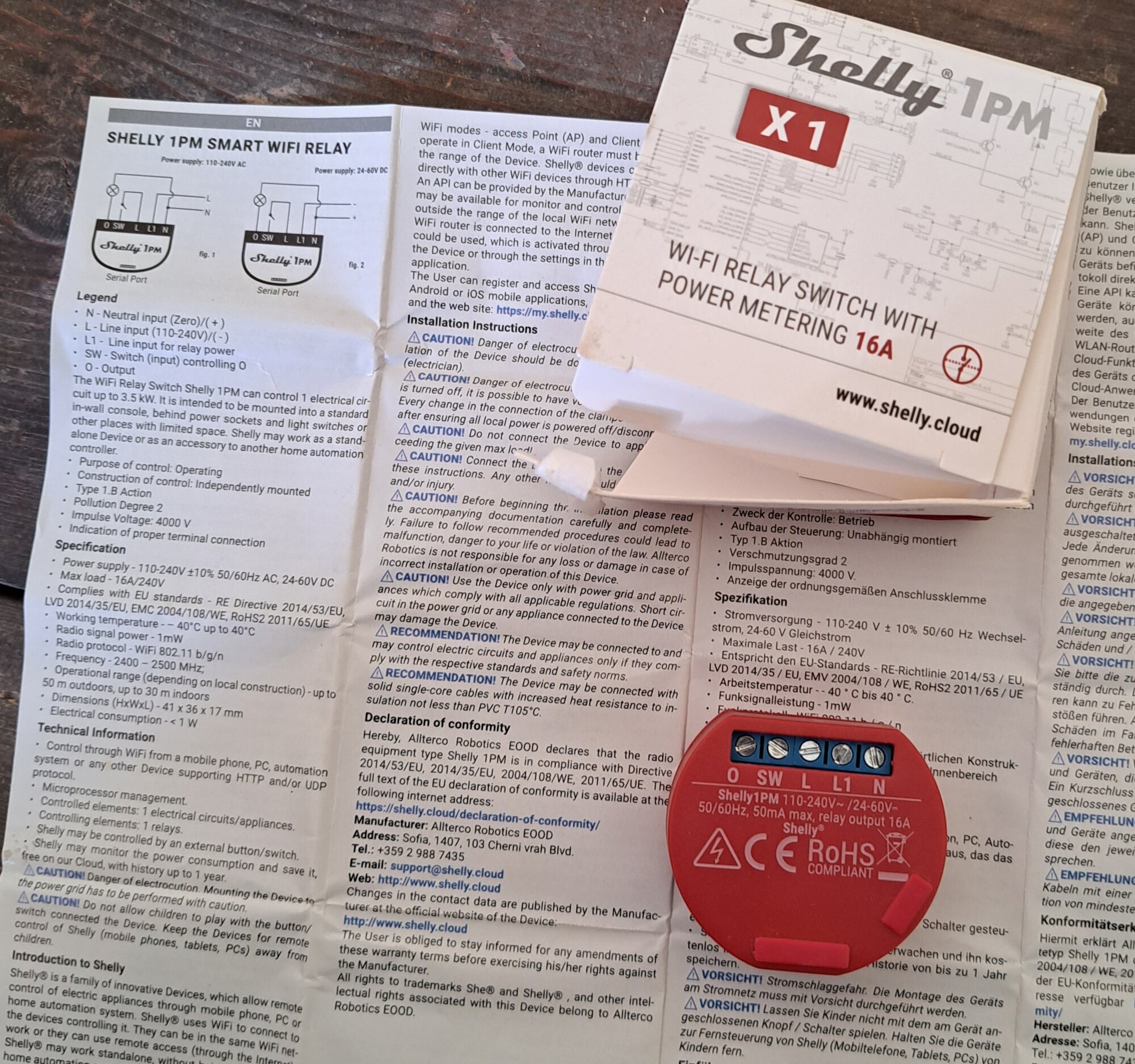

Hello all..
I have been asked to wire a relay into a FCU for a 3kW immersion.
The plan is for the customer to be able to access the immersion over WIFI.
The relay is a Shelly 1pm WIFI relay, 16A 110V - 240V.
I have not wired a relay before, hence asking on here.

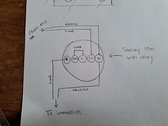

The wiring diagrams on the MI (see pic) show it being used for a light, which will include a light switch. Therefore do I just make a link between the L and SW as seen in my written diagram? Do I need the link, or are these terminals purely so the light could still be used from the switch?
I don't see how I can wire this directly into the FCU for the immersion as the relay has a common neutral, I would therefore loose the double pole function of the FCU. So, I'm assuming the relay would get wired into the load cable coming from the FCU going to the immersion?

What you suggest looks fine to me.
I would put it on the load side of the FCU as you propose as handier for anyone to isolate later, also just to flick off/on if it needs a hardware reset to get connection going again.
If you fit the relay on the load side of the FCU as per your sketchy sketch, then you still have D.P isolation by the FCU.

What do you think about the link between L and SW? Does this look like it is needed? I'm a little worried that this just means the immersion is 'on' all the time?

I don't think you should link L and SL - I think that is to allow an external switch input to control the output.
Looking at the instructions here:
It seems the L1 to L internal path is for power measurement, and then the L to SW link is for the relay that comes out on the 'O' pin (i.e. SW-O is the relay contacts and L1-L the measurement CT or similar). So it is linked up as it should be.
And I think I'd definitely be putting it in a separate box.
Yes, definitely!
The dimensions of 41 x 36 x 17 mm suggest it could go in a 25mm deep back-box with a blanking plate as a cover, maybe even a 1+1 back-box so FCU through the the relay unit all in the one area?
That's also my take on it - it's basically a manual override so needs to be kept unconnected (or connected to any old normal switch for use as a manual override, of course.). It's not the clearest of instructions! L1 may need linking to L, too, as I suspect that may be the internal power??

I think you may be right.
Other diagrams on the net showed a link between L and L1, this was when it was used to supply a socket.
Yes, looking at it again maybe that link is not needed. Probably best to play with it before you try to install at a customers site!
