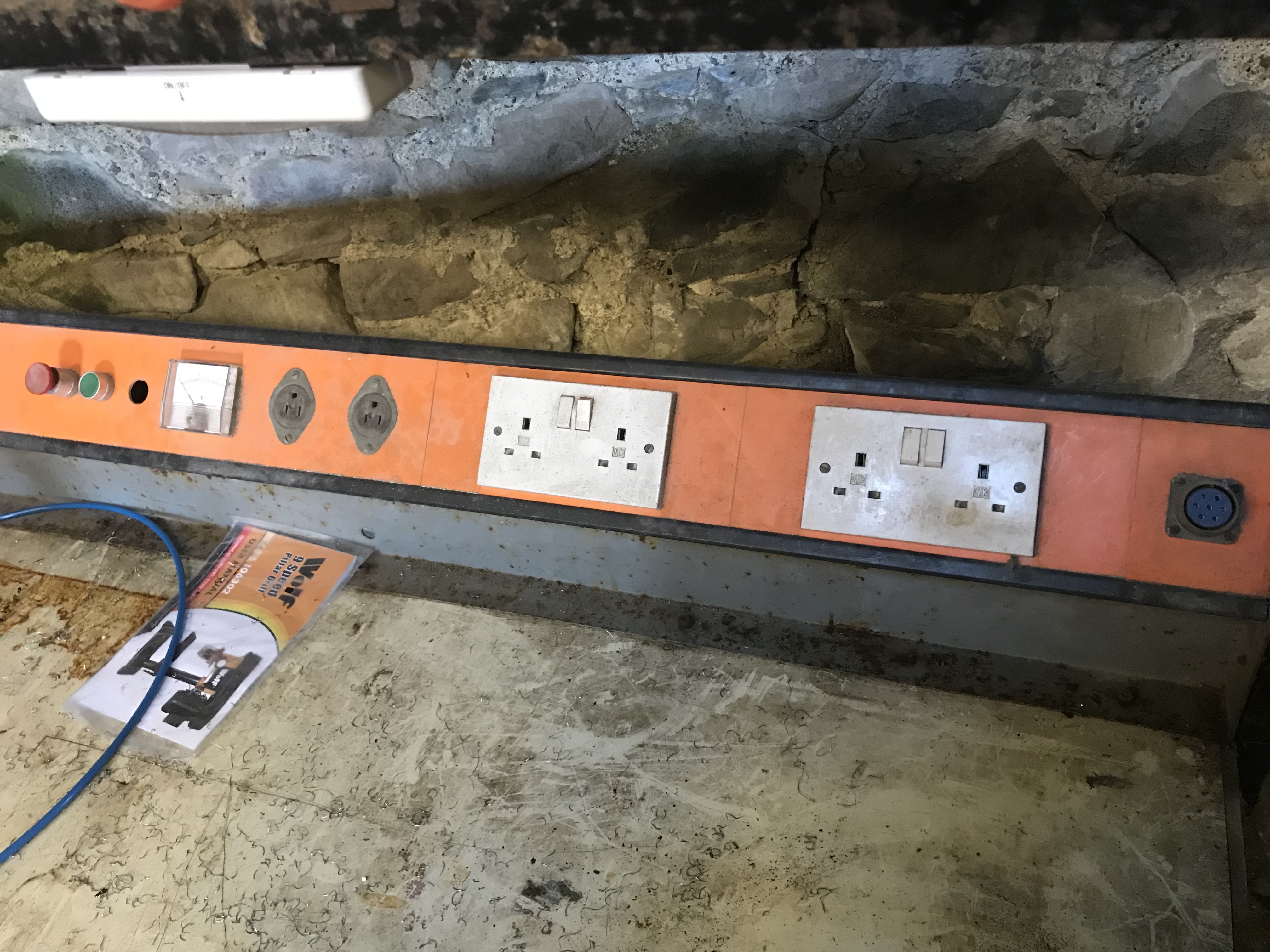

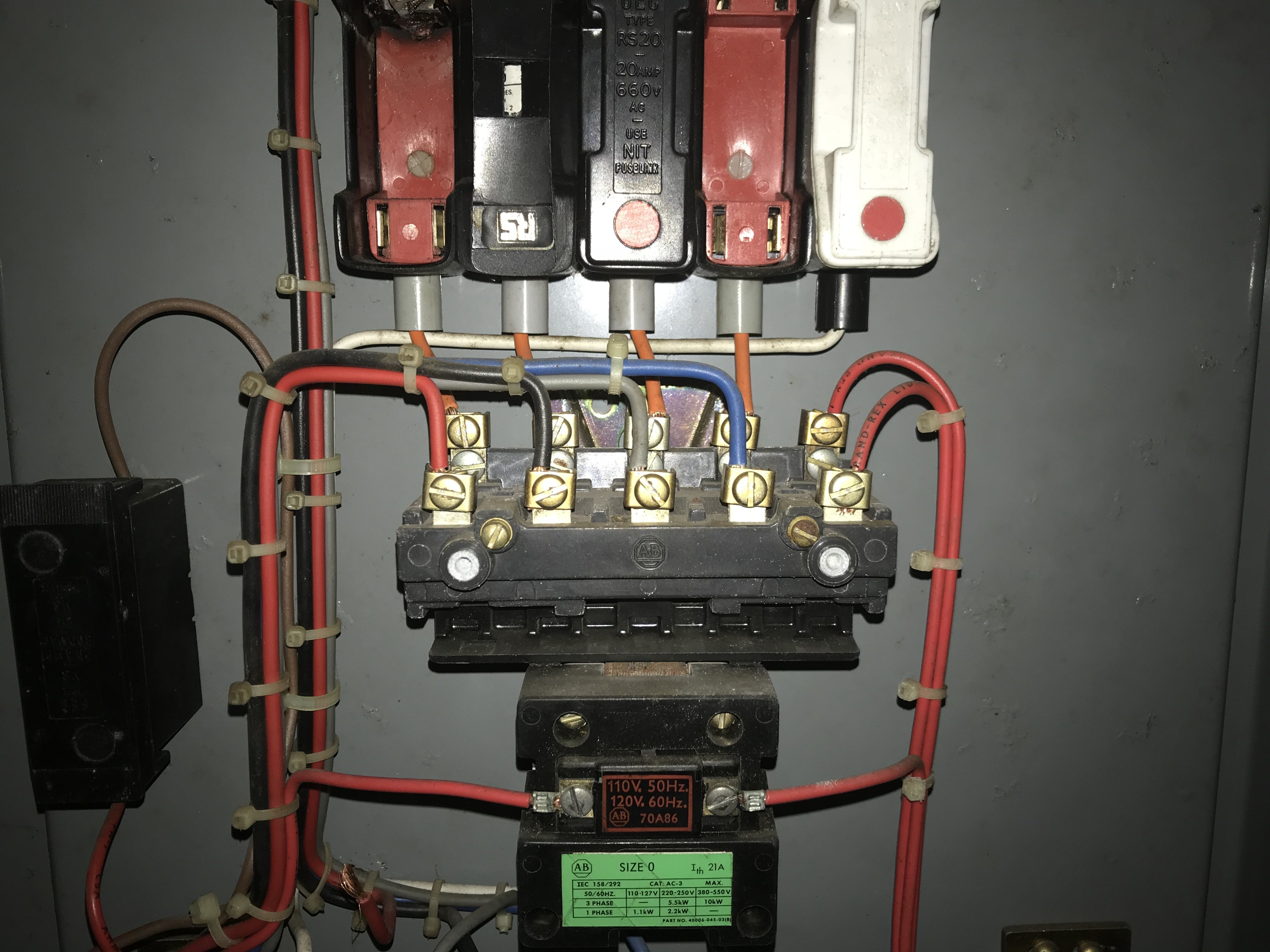

hi there, found this old workbench in a shed at a new house I’ve recently moved to, would be really handy for me if a could connect the sockets and the emergency cut off switches up for use with metal work tools etc, it has a large connections cupboard at the back and I can see some fuses are missing and on of the houses is burnt out, if I were to replace this how would you go about connecting it to power? Please see attached photos for detail

That bench would have been for a specific application - by the look of it there are two NEMA sockets to the left, and what looks like 7 pin Socapex to the right. Are there any clues as to what it was used for?
If you're just after a power supply for a workshop you'd be better off with a couple of RCD sockets.
Have you been skip-diving,outside a college,built in the 70's? ;)
To be honest,there is nothing useful on there,which could not be sourced as a modern equivalent,for reasonable money.
A nice,neat,blast from the past,though.
Agree with above - not really worth trying to re-hash. Although the sockets are a decent make, they are obviously seveal decades old, and probably been subjected to a lot of use when it was all in use as some sort of test/education bench - the contacts will have seen a lot of wear!
I'd fit a couple of new sockets (either RCD type, or fed from an RCD) and some fresh wiring. Where are you intending supplying the bench from - some flex and a 13A plug top?

Yep, keep the wood and the metalwork but ditch the electrics.

Thanks all for the replies! Have decided to just renew the sockets and wire directly to an RCD. Think whomever lived her before fancied them selves as a bit of a scientist, have found all sorts of potions lying around!
