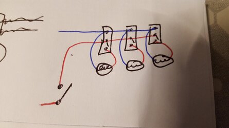

One of those ideas that sits at the back of my mind came back to me tonight and I've managed to run up against a brick wall with it. It's been a long term idea to provide external lighting as my parents move around outside and I'm not sure if this can be done as simply as I'd like. My thoughts have been to have two (possibly three) lights with separate PIRs running from a single switch and I'm not seeing a way of doing this.
I understand how to switch multiple lights from a single PIR and how to switch one or more lights (at the same time) from multiple PIRs. What I don't know, and can't conceive of, is how to have two or three PIRs on a single switch line, but with each PIR operating its own individual light. Am I right in thinking this can't be done or am I missing something really obvious?
I'm not sure I'm quite grasping the question...as I'm not yet seeing the problem.
I'm reading it that you want a light switch controlling a switched live feed, running to PIR1 which activates Light1, and on to PIR2 which activates Light2, and on to PIR3 which activates Light3.
So when the switch is on, it all happens, when the switch is off, it all stays dark.
Is that correct?
Ok, so the PIR's are only active when the switch is active. Correct?
What's wrong with wiring mains to the 2 (or 3) PIR's through the switch. Then from each output of the PIR to their individual light?
If I'm getting your point this is fairly simple - 3 cores to switch for N,E & L , then take 3 cores through PIRs for N,E & use SL to PL terminal of PIRs. From there take N,E & use L from SL terminal of PIRs to respective lamps?

My brain was intent on bringing mains to PIRs and trailing 4 cores between them, where triggering any PIR would activate all lights.
Thanks for simplyfying this for me ?
Though I was missing some fundamental as I've done similar a quite a few times only with PIR floods on a timer, not identical but the same in principle.
I might not be fully understanding what you're trying to achieve, but note that PIRs, in my experience are intended to have a permanent live. If powered through a switch, they will all switch on when the switch is closed, and light all the lamps for their pre programmed times, before starting to work as they should.

There were originally two lights from a single switch and I believe this was all in pyro from a terminal box. The porch was rebuilt about 35 years ago and at that time one light was replaced with a plastic pir lantern and that section rewired in T&E. Currently the pir activates both lights and all is fine, except the internal wiring still needs to be replaced and switch moved as it's now behind a newish inner door. The switch will have two ways - intermediate for hall light, as it currently switches from other end of hall and from landing, and the other way for front outside lights.
It may be that the existing set up with two lights remains or I might add a third, but it will all run from a single switch to keep it simple for my parents. The current set up works okay, but means no light if they walk round from the rear and they aren't getting any younger, so convenience for them is key
The main issue is activation from either direction, so I might simplify this by just using a pir lantern at the front and corner light at rear, with separate pir due to lack of choice for corner lights, then allow either pir to activate both.
