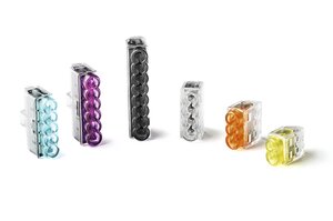

Bit late but I'd use these "quick connectors"
Used them before for sockets where the wires have been cut too much and was impossible to perform a splice in other way without running a new wire. The box says they're fine for up to 25 amps but I'm a bit skeptical of that, but for something like this involving LED lights I'd say they're more than fine.
Grab a few of the black ones and wire them together, then the lights. If you notice the cables are too thin (they look less than 0.5mm to me) insert two into each hole, make sure they're tight otherwise they could snap off and short the fixture.
