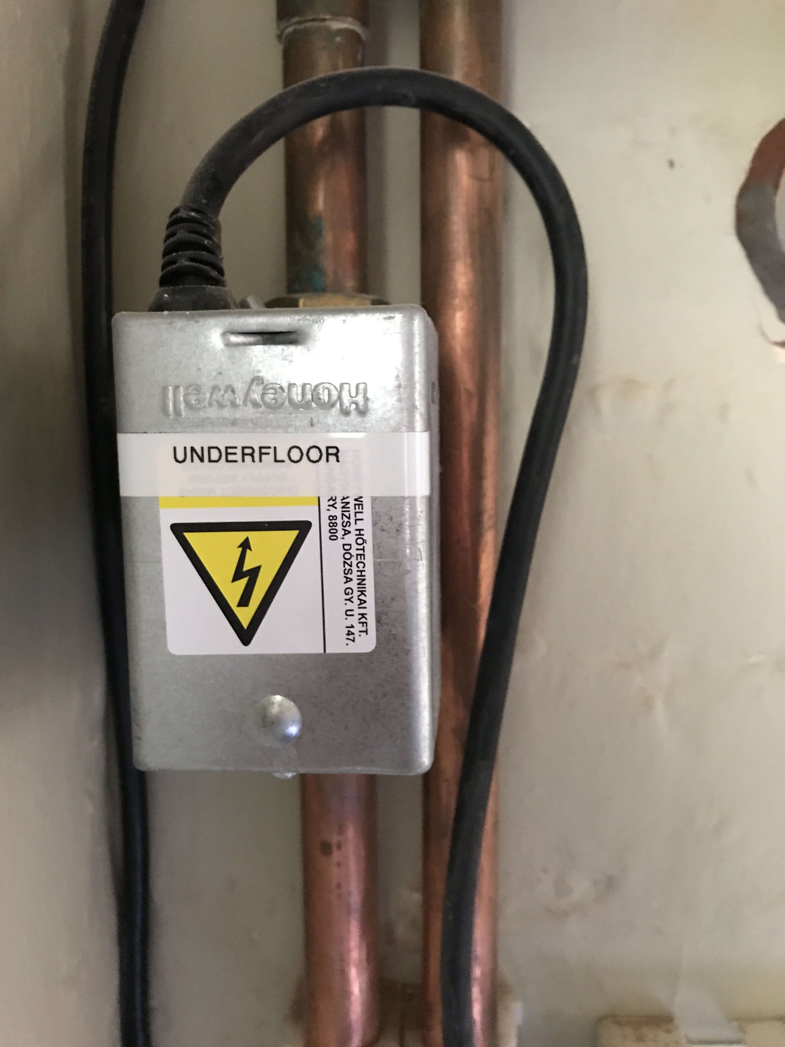

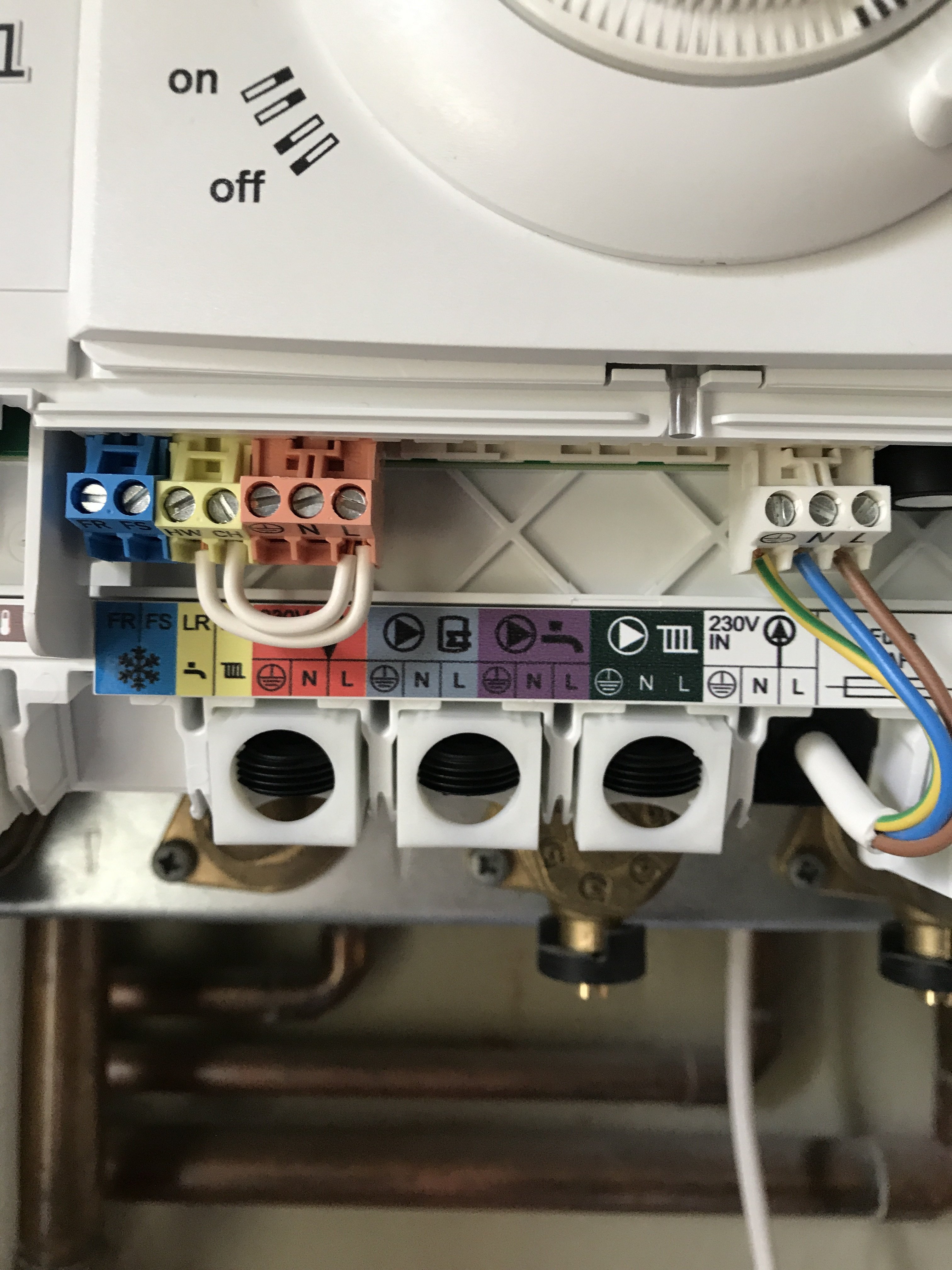

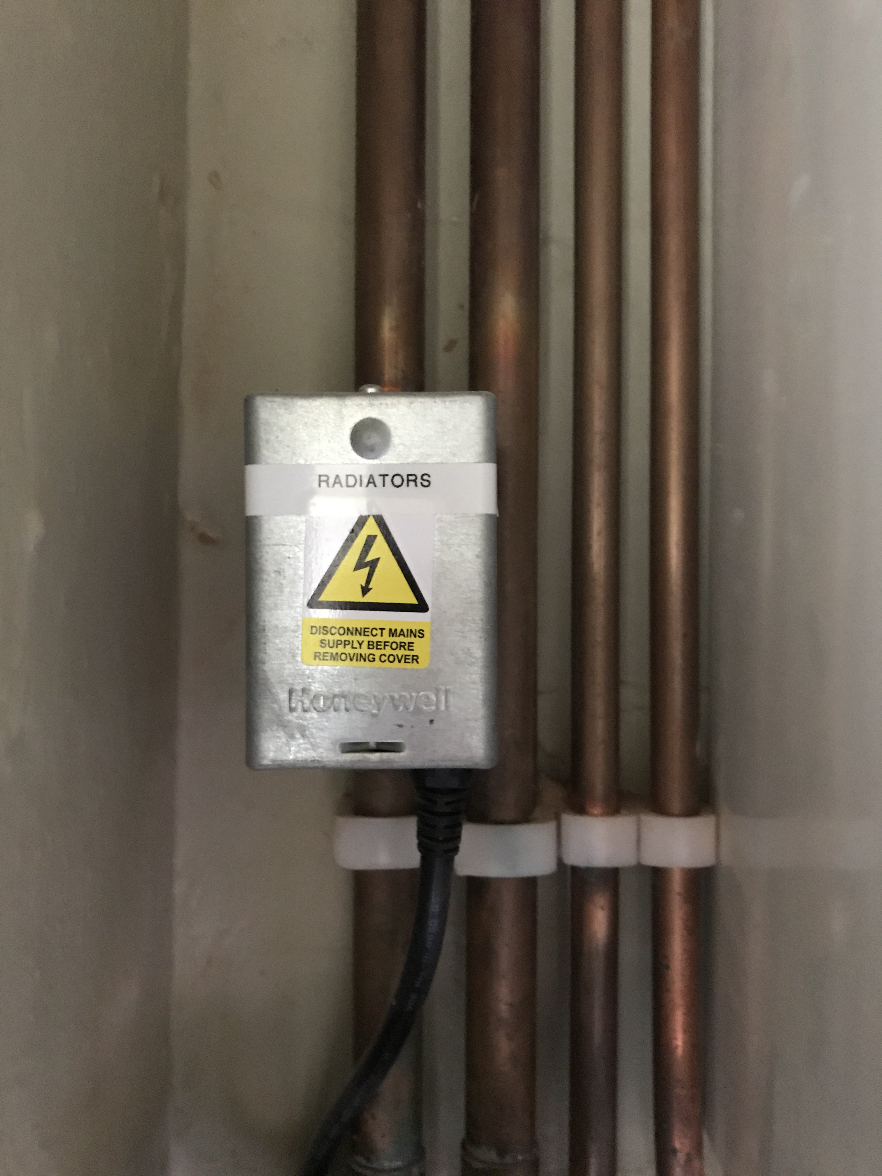

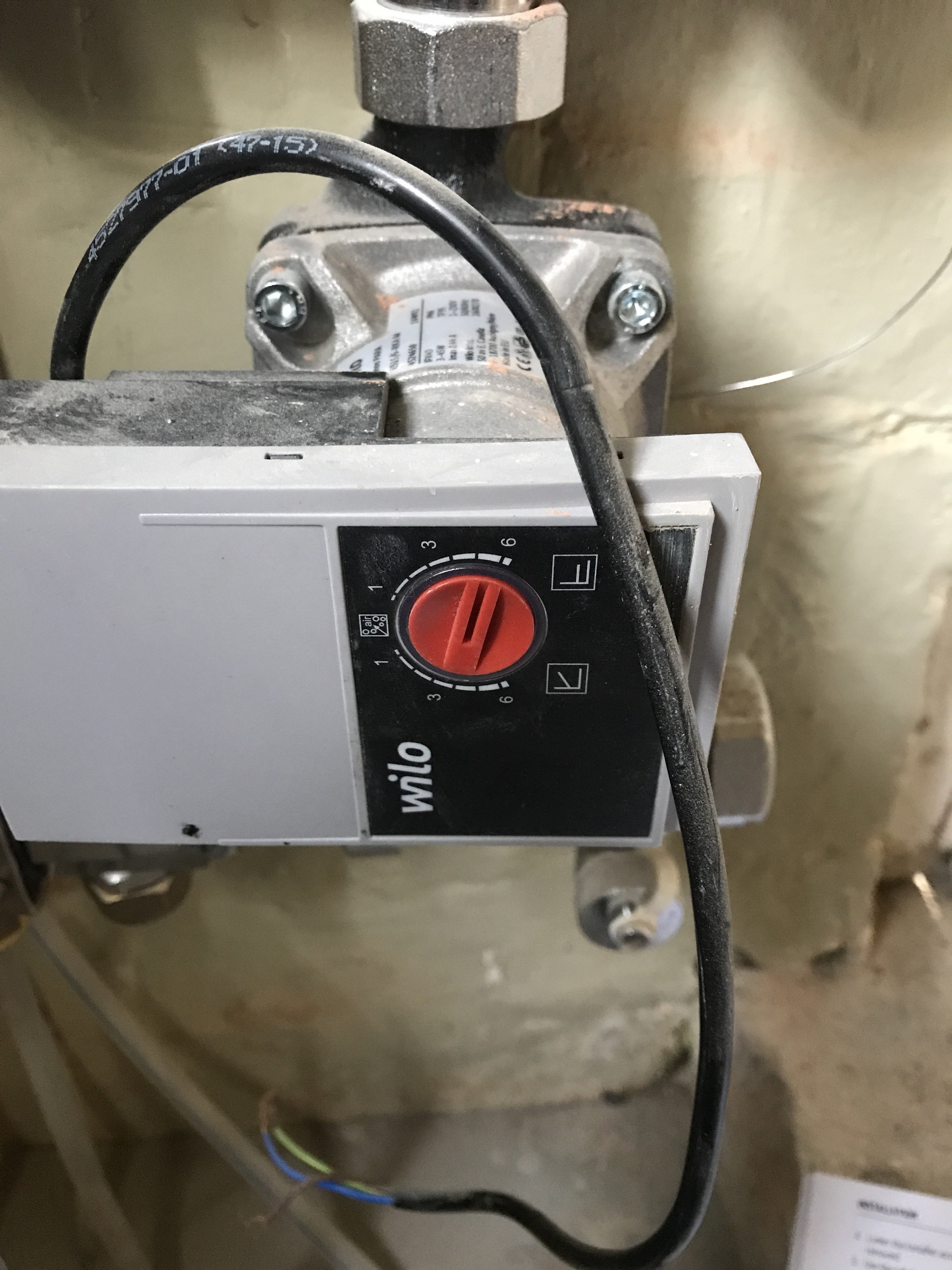

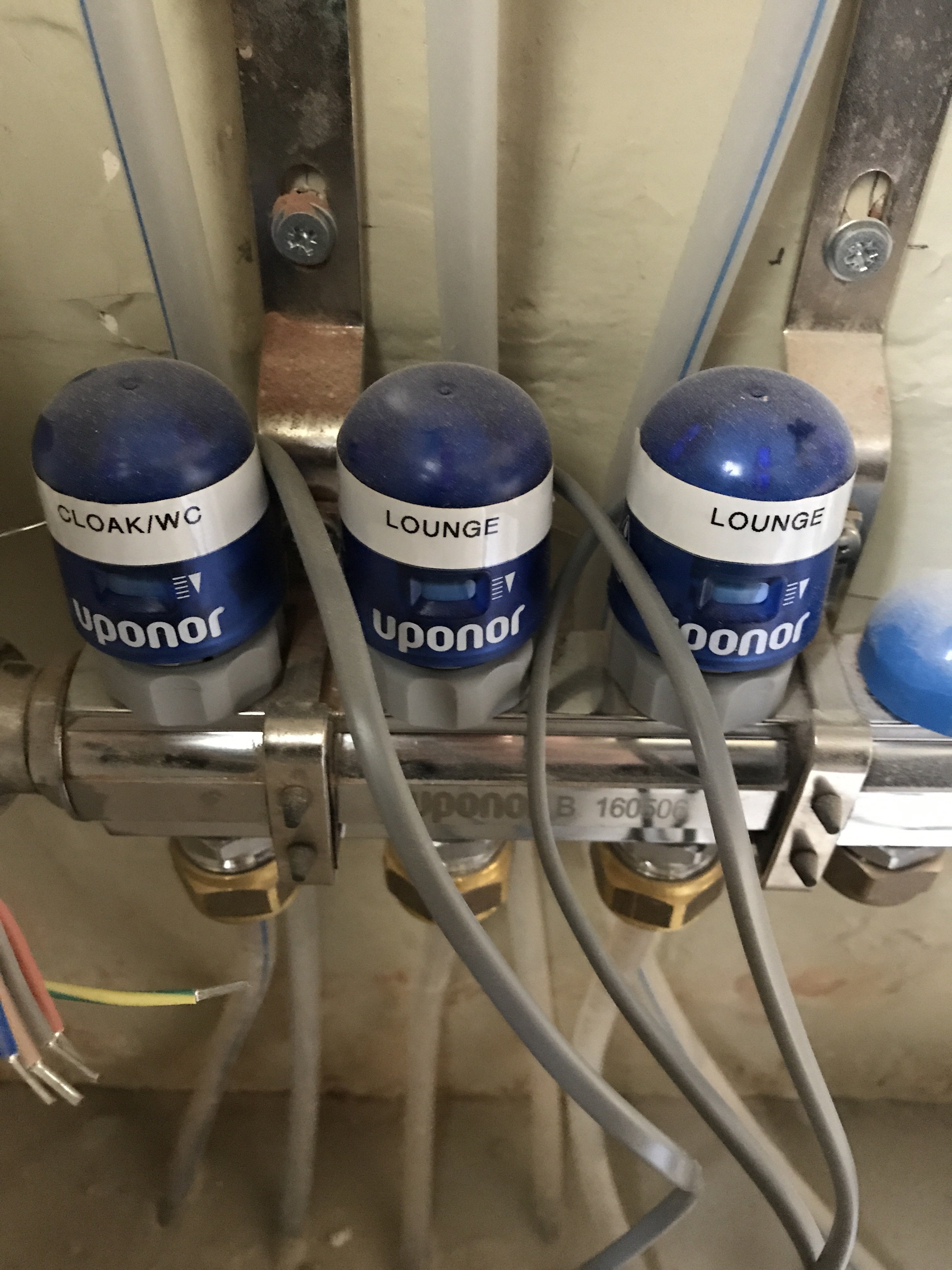

I am currently doing a rewire and have come to the connections for the heating system.
What I have is a Worcester Combi Boiler and an Uponor Underfloor heating manifold.
I also have two zone valves 1 for radiators and 1 for underfloor, I have a thermostat in place to control radiators and then have to thermostats to control two areas of underfloor, there is no DHW parts as this just comes on when hot tap is ran.
I have a 2 zone programmer to fit along with an Uponor wiring box to take the control wires for each zone at the manifold.
I can’t seem to find any wiring diagrams that incorporate what I have, has anyone done one of these or similar systems before and if so any wiring diagrams or instructions will be appreciated.
Please see attached photos of what I have in front of me
Thanks in advance
Adam

As above, just be aware that the actuators on the manifold may be DC operated (12V or 24V). Depending on what the UFH stats are connected to you may need a couple of contactors to control the actuators (one for each of the two UFH zones).
