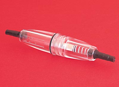

if you need to put in the 3amp protection for the fan you could use inline fuse carriers like these less rewiring required.
