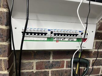

Anyone know if the reduced height, switched neutral Wylex RCBO's will fit in this enclosure? Planning to rip the all the devices out and start again with all RCBO, but don't want to change the enclosure. I seem to remember the newer Wylex boards have a different shaped flap on the lid?

Depends on the busbar.
The newer wylex miniture RCBOs only fit on the finger busbar as they don't have the slit in the front, also the busbar does have a kink in it where it connects to the L out of the main switch.
Trouble is the older Wylex busbar isn't as easy to get hold of, they do sell a AFDD busbar though.
Hager busbar is much easier to get hold of, you could change all the internals to Hager if changing the CU is going to be awkward.

Not sure if that would be permitted as it’s a wylex enclosure?
It’s very annoying how Wylex keep changing all the parts so they are not backwards compatible every 5 years or so. It’s mainly why I don’t use them!
I suppose I could rip it all out and start again with wylex finger busbar. Probably the best option.
The other problem if I fit Hager is will the front cover even line up over the devices?

There is no fault. It’s almost certainly an accumulation of earth leakage. I’d rather use the newer ones as they’re easier to work with!
I think I should be able to replace all the internals and pull the existing busbar out too. Then replace with new rcbos and new finger busbar.
I think the enclosure shown will have the busbar type that slots under the screw. Should’ve opened it up really ?‍♂️

If it has a "balcony style" (in Wylex parlance) bus bar, i.e. the one that fits under the screws rather than pokes up into the cage, then you might have a problem. Those with balcony bus bars only have half a DIN rail (the top half), when you place the protective devices into place the balcony bus bar is structural, keeping the bottom half of your devices fixed in place. So if you get all new devices and a new finger bus bar, then there's nothing to keep the bottom half of everything in place.
You could of course get the full height Wylex RCBOs, these are Type A, unfortunately they are not switched N, and I see it's a TT system so that may be your consideration.
Some of the more recent Wylex DB's - the "L" range (e.g. NM1106L) have a fixed, finger bus bar on the bottom and half a DIN rail, these are compatible with the newer devices. Unless the DB is one of these, or unless it's aleady got a finger bus bar of some sort, then you're out of luck.
