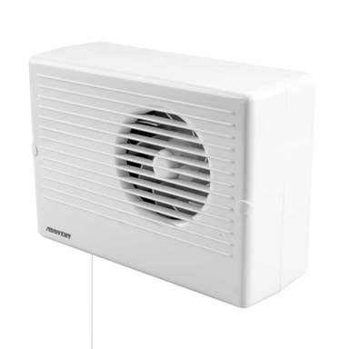

I have an old pull cord xpelair automatic bathroom fan for over 20 years. Was a pull cord operation. On and off. Bought the fan in the subject as a replacement. It has 4 mains connections. First one looks like 3 lines dont know what this is for. Next is N for neutral i take it. Then T, think this is if you want to connect to light. Next is LH which i think is the live. I only have 2 wire going to the fan. Live and neutral. When i connect them fan constantly runs. If i pull cord to switch on runs faster, switch off then just constantly runs doesn't. Can this be wired using just the 2 wires or shall i return it?
I want a powerful 2 wire pull cord fan any recommendations?
Thanks

The CF20t is timed fan, which also has a humidity sensor and different fan speeds selectable by the pullcord.
The reason it runs constantly when connected is the humidity sensor is sensing humidity, and in time will switch itself off when the humidity level drops due to the moist air being extracted out of the room. This sensor can be adjusted.
The fan will not switch on again until the humidity builds up, or the if the T terminal is connected to a switched live, usually the light switch.
Basically you have bought an expensive fan that is not the right one. You need a simple fan without a timer and with an on/off pullcord.
For example:
The earth connection is the first picture.
Yes it is an expensive fan. If i just connect neutral and live will it turn off humidity is low enough. I dont want to connect to light. I have turn down the humidity and timer right down.
This recommend fan what is the extraction rate? I want a top end one which is really good. Thanks for your advice guys
"turning down" the RH? I guess what is needed is less sensitivity to humidity?
I think to make the fan less sensitive, ie so it goes off, you need to turn the setting up!
Instructions (if I've got the right one!) "The humidity setting is adjustable between approximately 50% and 90% relative humidity. Using an electrician’s screwdriver, turn screw “RH” clockwise to increase the relative humidity setting and anti-clockwise to decrease. (Note: the fan is more sensitive at 50% RH than at 90%)."
So wind the RH adjustment clockwise (+)
