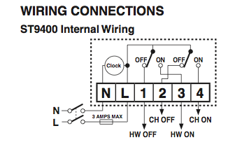

I currently have a very basic Honeywell timer/programmer connected to the heating system via the Y-plan.

So - as far as I can work it out in the y-plan at the programmer you have Neutral, Live and connections 1,2,3,4 (DHW Off, HTG Off, DHW On, HTG On). Obviously the On and Off Pins for each system are mutually exclusive - e.g. either DHW On (pin 3) is connected to Live or DHW Off (pin 1) is connected to live - but never both (and the same for the HTG pins.)
What I don't understand is how the neutral connection is connected - from the internal wiring diagram of my programmer and the y-plan schematic it appears that N and L are basically connected together inside the programmer - wouldn't this be a short circuit? Or is that just to provide power for the programmer itself?
Basically what I'm asking is - in my four relays can I just connect live to the central poles and pins 1-4 to the four contacts, or does neutral need to be connected too?

The diagram shows L and N connected to "Clock" so, yes, the neutral is just required to power the programmer's internal timer.
And, yes, connecting the two common central poles (2 and 5 from the left in the bottom row) to live and the four relay outputs to the CH on, CH off, HW on and HW off would work. If it's a Y plan you'll probably find that one of the "offs" is not required and not currently used (can't remember which).
You would perhaps have been better to have used two single pole, double throw relays rather than four single pole, single throw relays; you'll have to make sure that you don't energise an "on" and a corresponding "off" at the same time.
