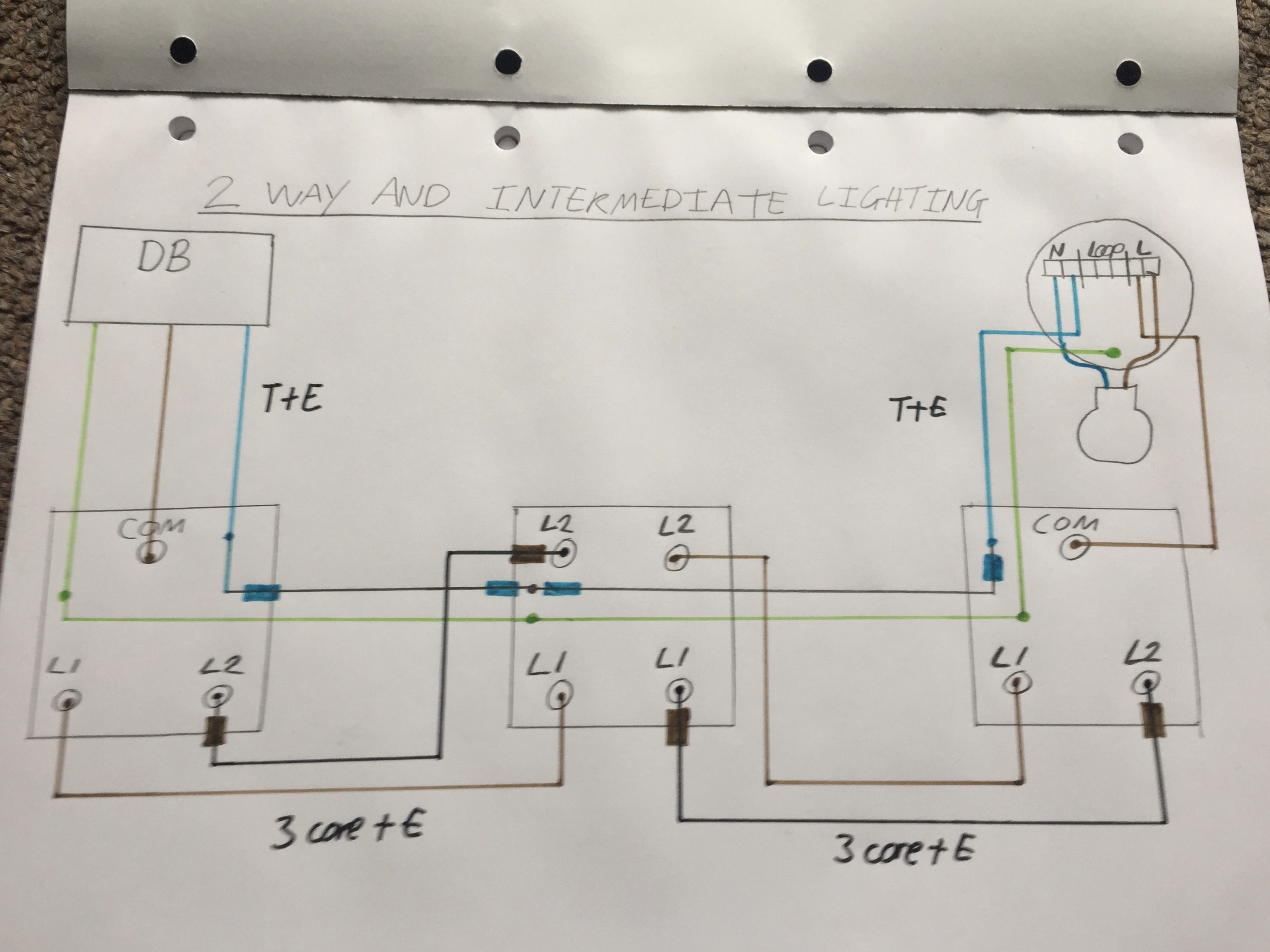

Yes mate, it’s a TP&N supply and board. Mine was a Schneider with the slider switches for each way if that makes sense, remember to turn these on as well as the circuit breakers depending on the way you want to test. I did a global insulation resistance test with everything on, I bypassed the dol starter, disconnected the light, carbon detector, rcbo, and left the heating spur off as you don’t test the load side of the heating system. Just remember to operate all your light switches so you test every piece of cable. I forgot to do that on my insulation resistance but he’d watched me do it for my R1+R2 so he let me off thankfully as you do find yourself clock watching and stressing more than you would at work. Where are you taking the test?
This reply has helped me so much mate I really appreciate it! I’m doing mine at JTL Birmingham mate same Schneider board, yeah I’ll get him to switch switches on on continuity and IR. did you have to carry the neutral through switches for your 2 way and intermediate
I’m glad I’m able to help. I think if you sort of expect what’s coming it helps with the nerves a bit. Yeah on the lighting you’ll take a twin and earth to the first switch, a 3 core to the intermediate, a three core to the last switch and another twin up to the light, wago the neutrals and earth using grey as neutral and black and brown as your strappers. The feed from db to first switch the brown goes in the common. It’s exactly like this picture mate. Just watch the spec. As they have 1mm twin and 1mm 3core out to pick from but the spec says use 1.5mm so check everything’s the same as on the spec drawing you get.
[ElectriciansForums.net] Ze & Pfc (Pefc & Pscc)
Legend mate!! Yeah I’m little nervous but I think I’ve prepared enough to have a good crack at it. I’m just nervous about live testing. I am assuming the supply to the testing board will have a rcd so I’m going to ask him to ensure I select the right settings to avoid tripping the rcd (3 lead low) I have told we have to do pfc (pefc) + (pscc) and take the highest reading X2 but as it’s 3p&N the highest reading would normally be between L-L/L-N. I’m just trying to practise filling out test certificates as I would hate for that to be the reason I fail. Any other tips you can give would be appreciated a lot. Thanks for your help mate
