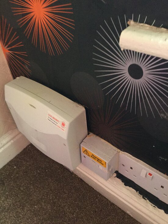

Hello everyone,
Moved in to a property some months ago, never did bother with the Burglar alarm until today I had a power cut which set the alarm off. At which point I realised I do not have the codes to stop it once it does start sounding.

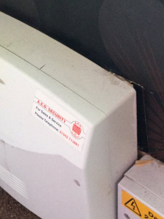

I tried to contact the installer (AED Security Wigan) for assistance but they dont appear to be an operating company anymore. What are the general next steps to do in this situation? I'm not entirely sure what brand the alarm is (pics below) So not entirely sure how to find any information about any codes I might need.
Pics
Main box - IMG 0088 - https://ibb.co/d76Jrv

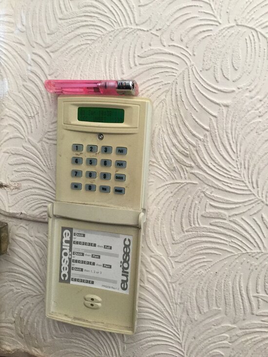

Keypad - IMG 0090 - https://ibb.co/hWZMBv
Does anyone know what alarm this is? Ideally i'd want to be able to get the codes to disarm this when it sounds. But if thats not possible, i'd like to just turn it off altogether, can anyone advise on how to do this? Is it as straight forward as turning the RCD off then removing the battery? Usually when i turn the RCD off it starts to sound straight away.
thanks!
M
You could take the battery out of the panel and bellbox and remove the fuse from the fused spur. If you want a functioning alarm then get an alarm company out who will be able to default the panel to default codes.
Just for future reference for anyone reading, if the alarm sounds during a power cut this usually means the battery in the panel is flat. In order to disable completely the battery in the bell box also needs to be removed.
Also,some models have an inbuilt default to error,after a certain number of operations,in other words,after turning the alarm on and off,2000 times,say.
