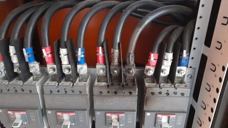

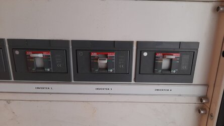

Hoping someone can give some input on what could be possible causes of what happened here. I am going to investigate the situation next week but for the time being I am trying to get as much input as possible to possible causes .

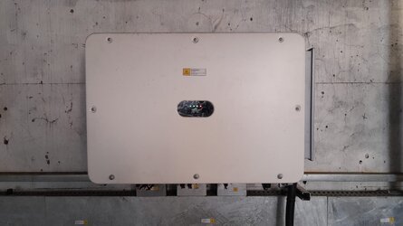

The install consists of 7x 100kW Huawei Grid Tied Inverters ,the system has been running smoothly for the past 9 months, faults came through on the monitoring platform and when an technician was sent out this is what was found .
My first and quite frankly only reasonable explanation is a loose connection ,but ,to the best of my knowledge a loose connection would have burnt out locally (at the point of termination where cable was loose ) . But in these pictures the cable is burnt out both at the inverter and then all the way back to the circuit breaker in the distribution board .
Any other ideas would be greatly appreciated and if my thinking about "localised" damage is incorrect if someone could explain otherwise that would also be greatly appreciated.

Just watched the vid again, I think you are right, there is some shiny stuff there possibly from arcing between the 2 terminals.
I wonder if there is any animal parts that have been well cooked between the terminals that started an arc going?
So the 'apparent' short is at the inverter and your fourth image is the mccb. To me a short has occurred at the inverter and tripped the mccb with the conductors contaminated by vaporized copper exhausted by the mccb.
Well ,I say sealed but what I mean by that is sealed from natural elements . Also very unlikely that someone tampered with it because only 3 people have keys to the inverter location and it would be in none of their best interests to even enter the cage for any reason other than if there was a problem. I guess I will hopefully find my answer when I go investigate for myself during the week
It wasn't me that went to the site, it was the funders site representative that went to check the site out ,I was made aware of this after he had left the site and sent the pictures (I am the installation contractor)
If there was negligence on one of my guys behalf when it was initially installed last year and the terminal was not torqued ( unlikely because I check and then then the installation undergoes quality checks by a 3rd party) but if it was loose connection would there not at least been a minimum been a considerable voltage drop ? In which case the inverter would have pushed warnings a long time ago
If these are grid tied inverters then you have the other issue of grid generated fault current if there has been a breakdown of the phase barriers in the inverter. We have had some great weather recently and it possible the inverter could have initially generated thermal damage through solar action and the grid has finished it off.
Total guess of course, what really matters is who pays for all that damage.... eek
