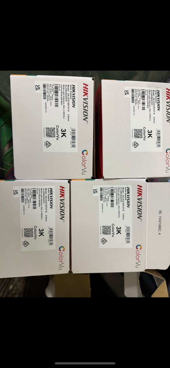

Hi what cable make and size would be needed for hikvision cctv cameras 2.8mm model number DS2CE72KF3T-E
picture provided
They're not power over co-ax are they, in my opinion never do it this way. I don't mind co-ax CCTV, the picture is just as good as the POE cameras but I would always run separate 12V power to cameras (even the POC cameras have a separate 12V connection. The one and only time I tried POC I had nothing but trouble with the cameras losing connection, you just need the slightest movement on the BNC plug and the camera goes off and re-sets itself constantly.
