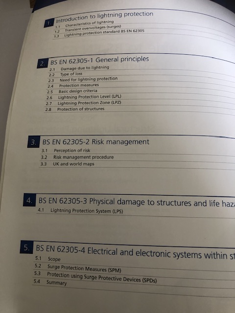

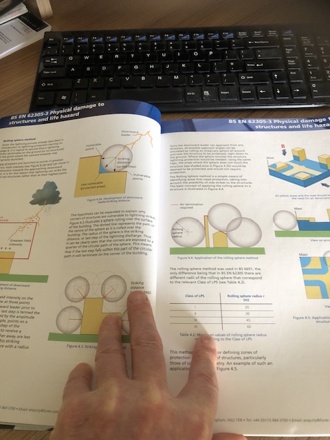

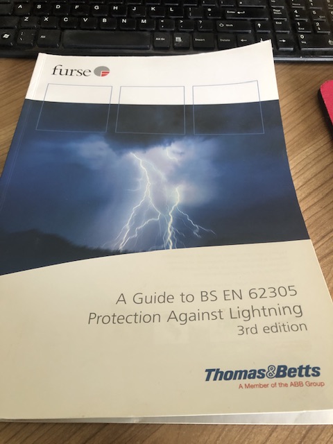

Not strictly speaking what you're asking for, but Furse do a really comprehensive guide on the subject - I've had my copy for several years now but at the time it was free.
136 pages of usefulness!!
I have the Furse booklet and it is really useful, seems to include most aspects! But not all unfortunately.
