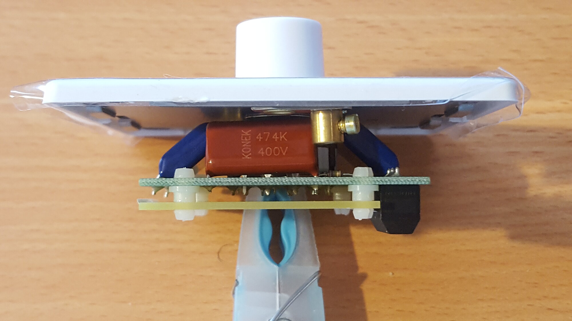

Well, with the bank balance "a bit lighter" I now have part of the answer. This is the wall controller Fantasia sell :
So capacitive voltage dropper
Since it's a standard switch with shaft with flat on it, I reckon there's a good change the module will fit one of Varilight's grid adapters (they do them for a range of grid systems). I guess I'll need to buy some bits and see if it fits, and how many adjacent modules it's going to block.
I do like the way it's marked as not to be used for inductive loads ...
So I start thinking along the lines of separating the board from the switch and either mounting it in the back if the box, or in a separate box in the attic.
And tgen I think, if I do that, just do away with the controller and run a 6 core (neutral, earth, lights, 3 fan speeds) cable to the fan. With one of those "doh, why didn't I think of that sooner" moments !
I'd just have to dive into the internal wiring to bring out the 3 speed tappings, and buy a suitable switch. I'll find another use for this unit.
