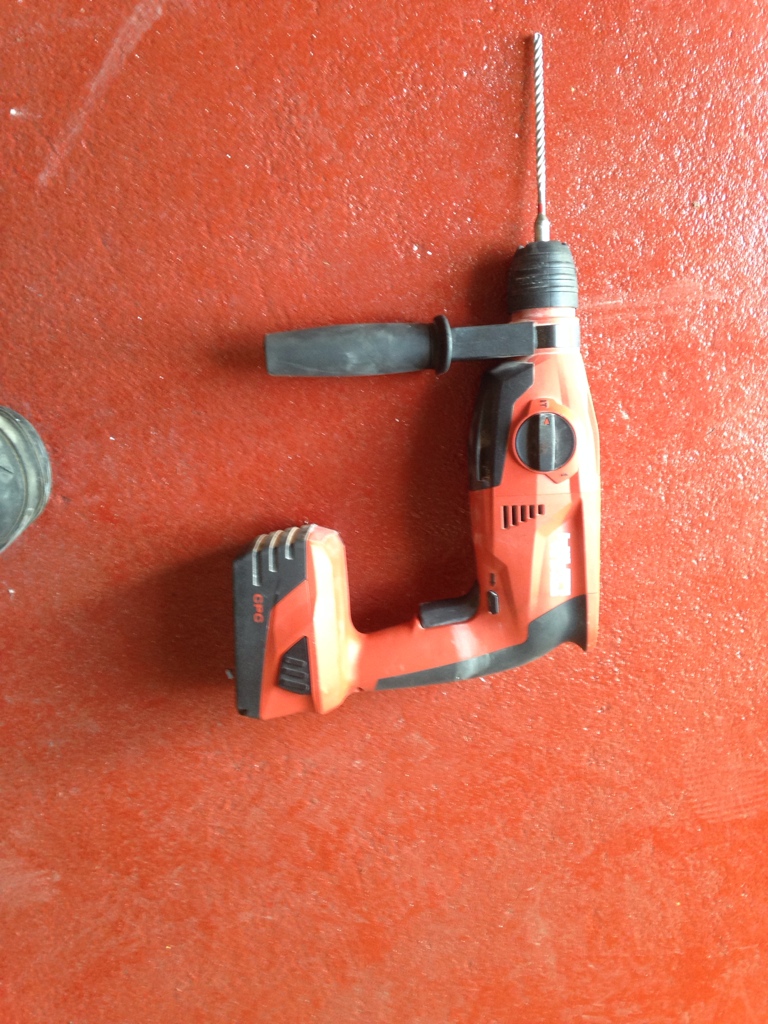

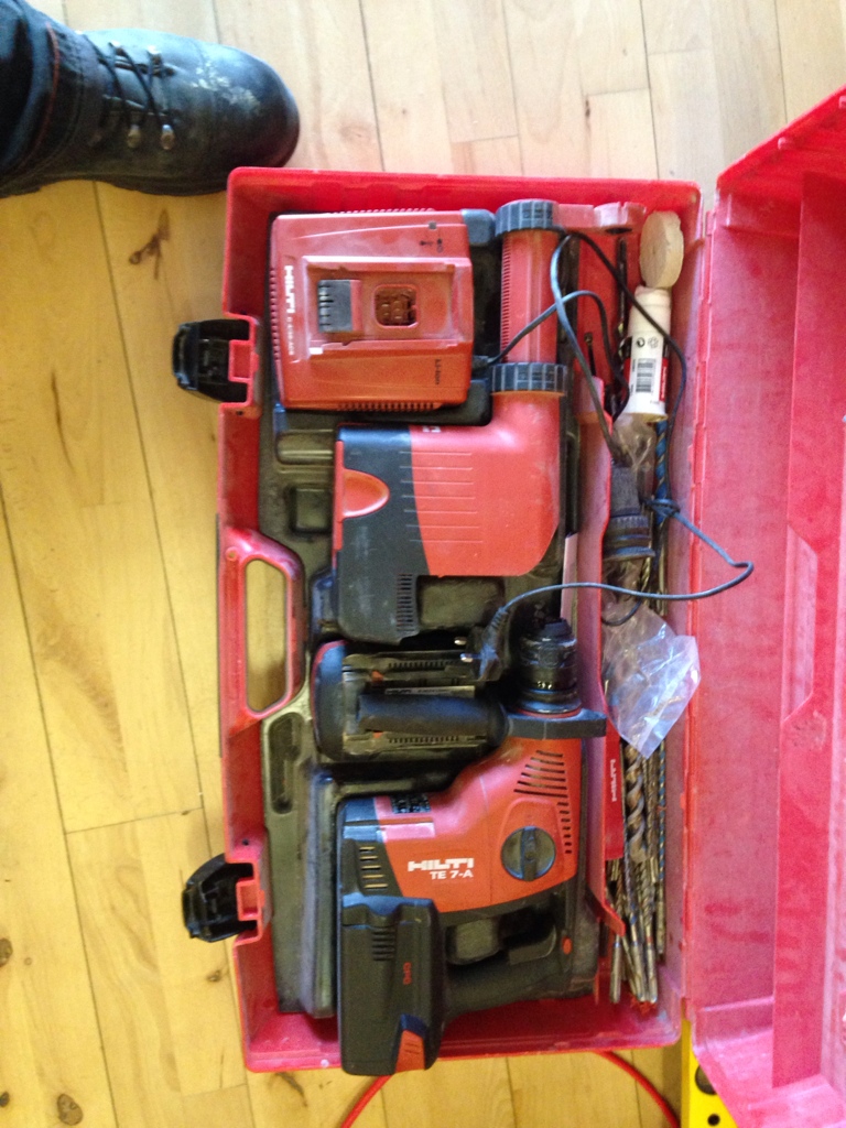

I replaced my 36v Bosch with this.......
The Bosch was good but this was better and the dust extractor doesn't half save a load of vacuuming!, however it's a bit cumbersome and quite heavy so to compliment it, I treated myself to this .........
For anchors and plugs, absolutely superb and I can get all day out of 1 battery!

I paid a about the same for my smaller Hilti TE-2, (the bottom pic) and although I do rate Milwaukee, Hilti is still far superior! With much better service
